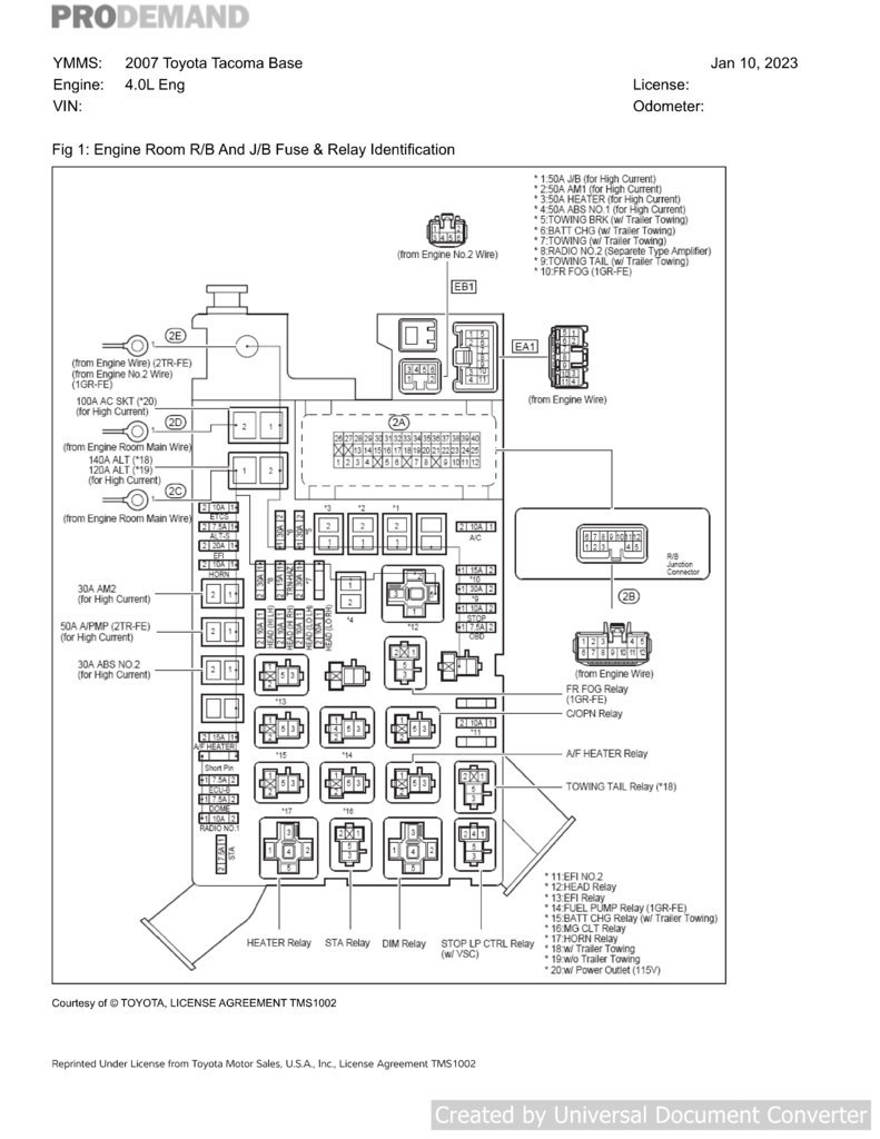

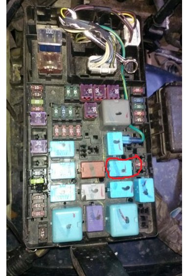

    @Dm93, can you give some instructions on how to jump out that relay? And, I'm assuming the relay you mentioned is the redish relay I pulled to relieve the fuel pressure on the lines before disconnecting them?
    TIA!

    The Red relay is the Fuel Pump Relay, the Blue relay to the right of it is the C/OPN Relay.
    If you jump Pins 3 & 5 (larger terminals) and turn the key on the fuel pump should run.
