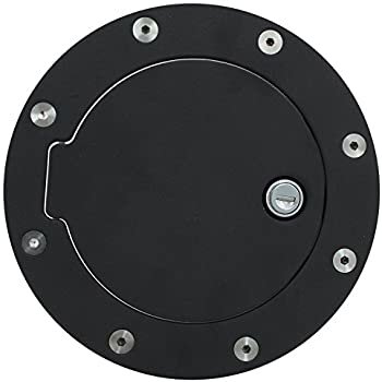

    It would be nice to have the option to replace the door with something like this.
