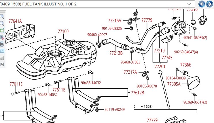

    This is NOT the right part number for the hinge rivets. this is the rivets for the filler neck surround (the black part around the filler). I, too, need to find some hinge rivets so I can replace my fuel door. They are much bigger and have a thicker head than the 90269-06017.

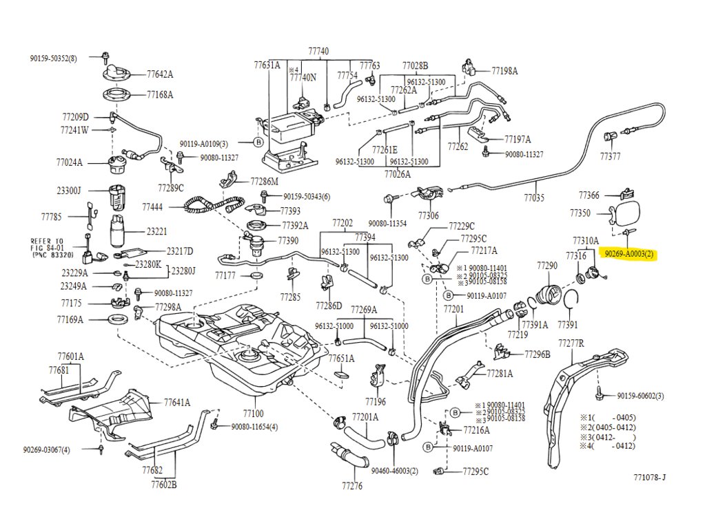

    I just found some listed as 90269-A0003... these look promising... If they don't work, I'm gonna go the 1/4-20 route...

    Thanks @JonathanH. I ordered these rivets (90269-0617) and either they sent me a bag that was mislabeled or these are not the right rivets for my fuel door. I'm gonna order some 90269-A0003 rivets and see if they're the right ones...

    90269-A0003 should be the rivets for the 3rd gen. But, anything is possible. I've gotten mispacked parts from Toyota plenty of times.
