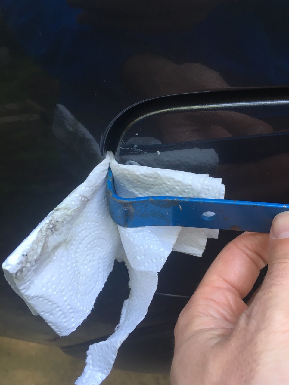

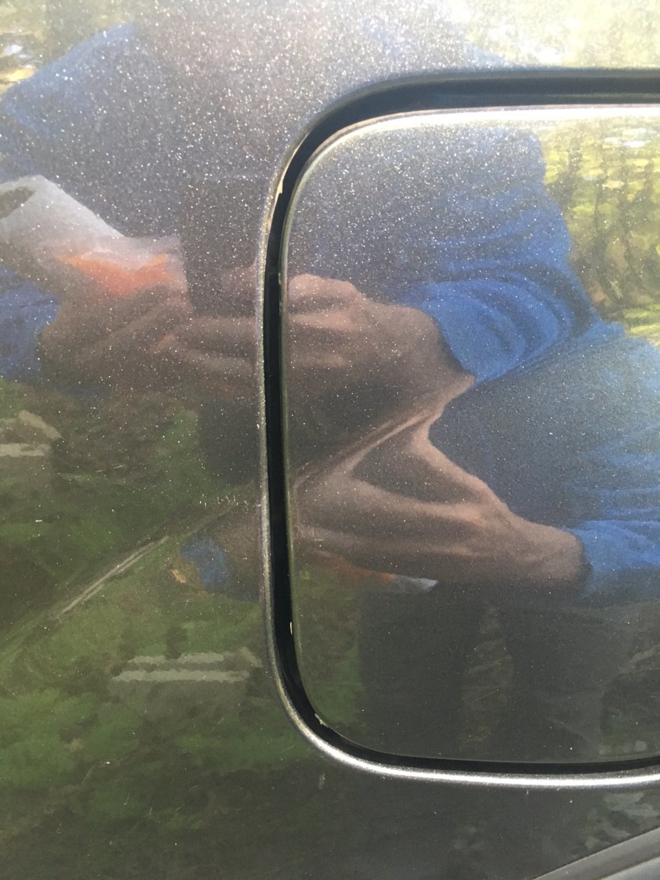

    This thread helped me solve the same problem on my 2013. I bought the plastic tools off Amazon, but found that they weren't rigid enough to handle the prying that was needed. They just bent under any type of prying pressure. I used a small metal pry bar with some paper towel as protection and it didn't damage the paint. In the pics you can see the reveal on the fuel door is slightly tighter at the top left than the bottom left. I put the bar in as shown, and rotated clockwise (pushed down on the handle). I had to gently pry it for a little while until it got to where I wanted it. I then greased the hell out of the hinge and will spray some lithium grease on it at every fill-up. IMG_6951.jpg IMG_6954.jpg
