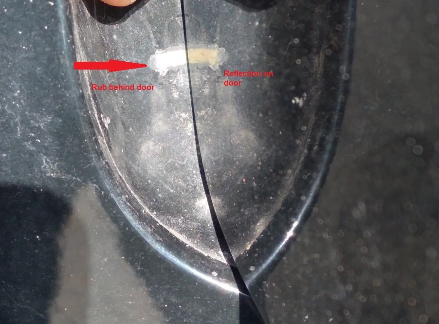

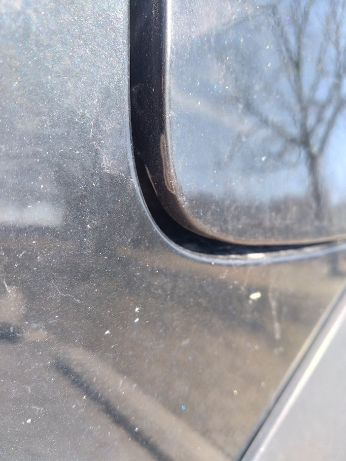

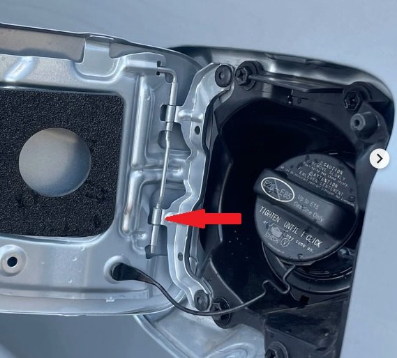

    The hinge pin is also the torsion spring. If it isn't routinely lubed where the sheet metal wraps around it, it will seize to the bracket at the red arrow below. Then, when you open the fuel door next time, it pulls on the bracket until breaks free. But not until after it deforms the bracket enough to kick out the bottom of the fuel door. It can/will rub the the paint off the bottom corner of the door every time you open it until the bracket gets straightened out.
    I got mine back to tolerable. But not perfect. I am waiting for it to warm up a bit more before I attempt anymore work.
