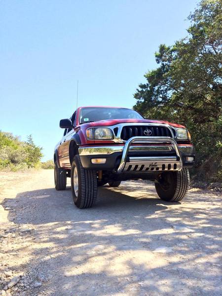

    Thought I would pop in to post my results. Going from 265/50R20 tires (40lbs tire + 40 lbs wheel) to the Bridgestone Dueler Alenza+ 265/75R16 (40lbs tire + 30 lbs wheel) I gained 2 MPG highway. City immeasurable at least for me.
    I would have bought the Michellin MS/2s if I didn't have 30% off Bridgestone.
