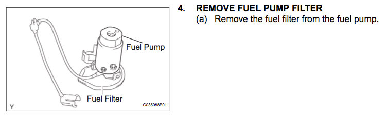

    Assuming your talking about the fuel filter assembly? If so as Shelf Life noted, it's in the tank... Many manufactures are switching over to in tank filters. I don't personally have experience with Tacomas but I have replaced in tank filters in Subarus. A unique difference however is that Subaru for instance uses a sock filter as found on the Tacoma in addition to a secondary more traditional paper media filter for very fine particulate. I like this system better and have toyed with the idea of adding a secondary filter in my tacoma but I probably wont, our trucks have proven themselves more than capable.
    From the Toyota FSM

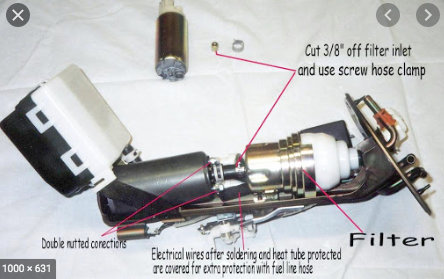

    Subaru's design, the plastic box attached to the inlet of the pump contains the sock type filter like that Tacoma however you can also note the secondary filter labeled in the picture.
