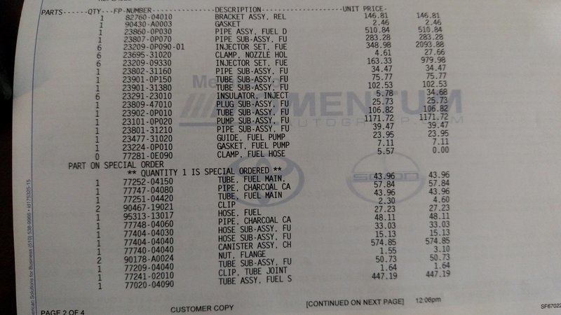

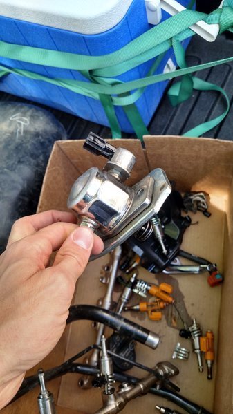

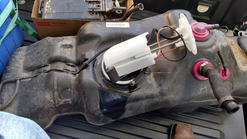

    Negative, sand was able to get past the in tank "filter" and destroyed my fuel system. It was a very small amount of sand as well.

    mine failed, and I ate it.

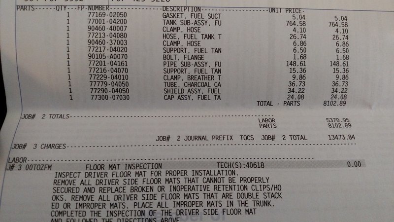

    Which I am now paying for. Insurance said they only cover the in tank items, it took a lot of work and convincing to get them to cover the whole deal.

    Here's some quick pics of the 16's fuel system
