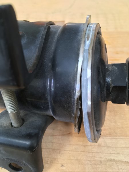

    Replaced the original fuel filter on my 2.4 DD at 124k and decided to take a look inside.
    Grinding-off the inlet side edge gave access to the paper filter element coiled inside:

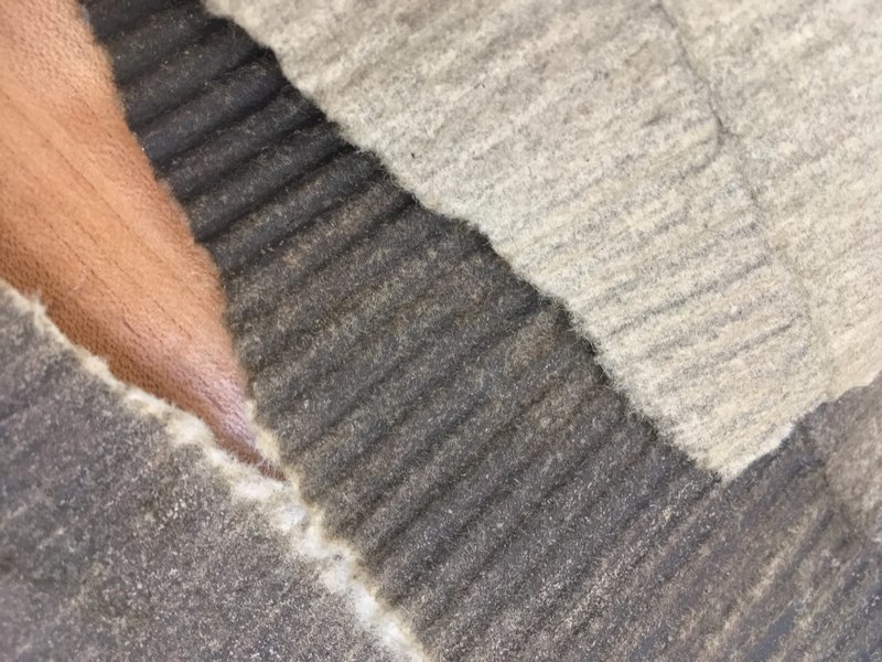

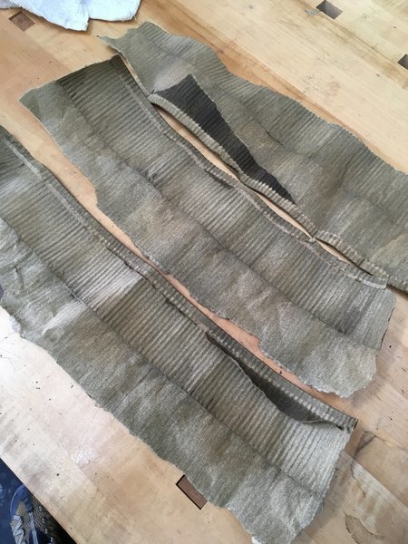

    Filter element removed and unfurled. Dirty side:
    Clean side:
    Close-up of the difference:

    I change mine every 20K.

    I wonder what it looks like inside after only 20k.

    With the crappy gas we get here, it is black every time.
