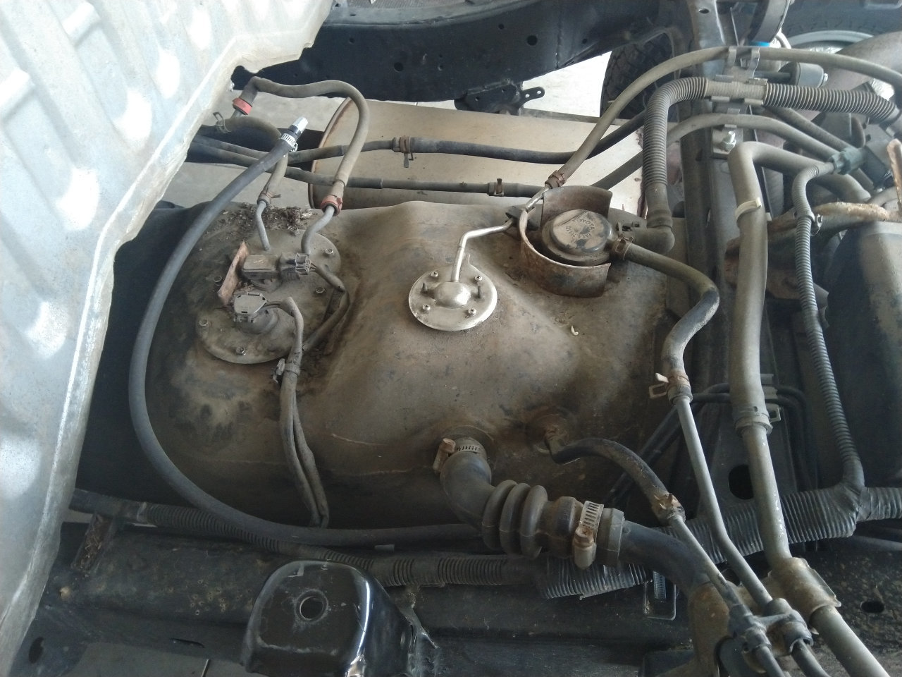

    That pic looks like a den of vipers...:devil:
