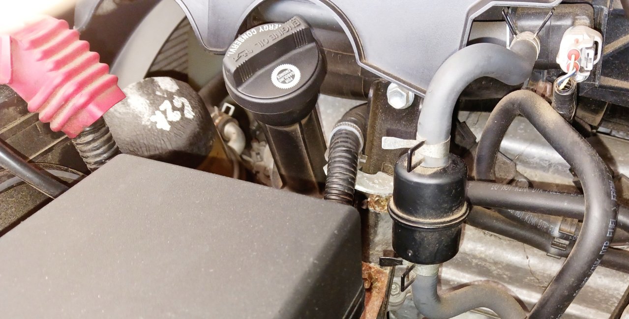

    Ok, no frame rail filter, so what is the filter in the engine compartment on the driver's side?
    Ok, so no fuel rail filter, in tank only? So, tell me about this engine compartment filter. See pic. 20220804_091019.jpg

    That's not a filter, it's a surge tank/resonator for the EVAP purge valve.

    Ok thanks, I'm used to seeing older cars with surge tanks components much larger than this. So I'm assuming it never needs changing?

    No, I'm pretty certain it's just a hollow canister.

    Only needs replacement if it rusts through or develops a vacuum leak.
