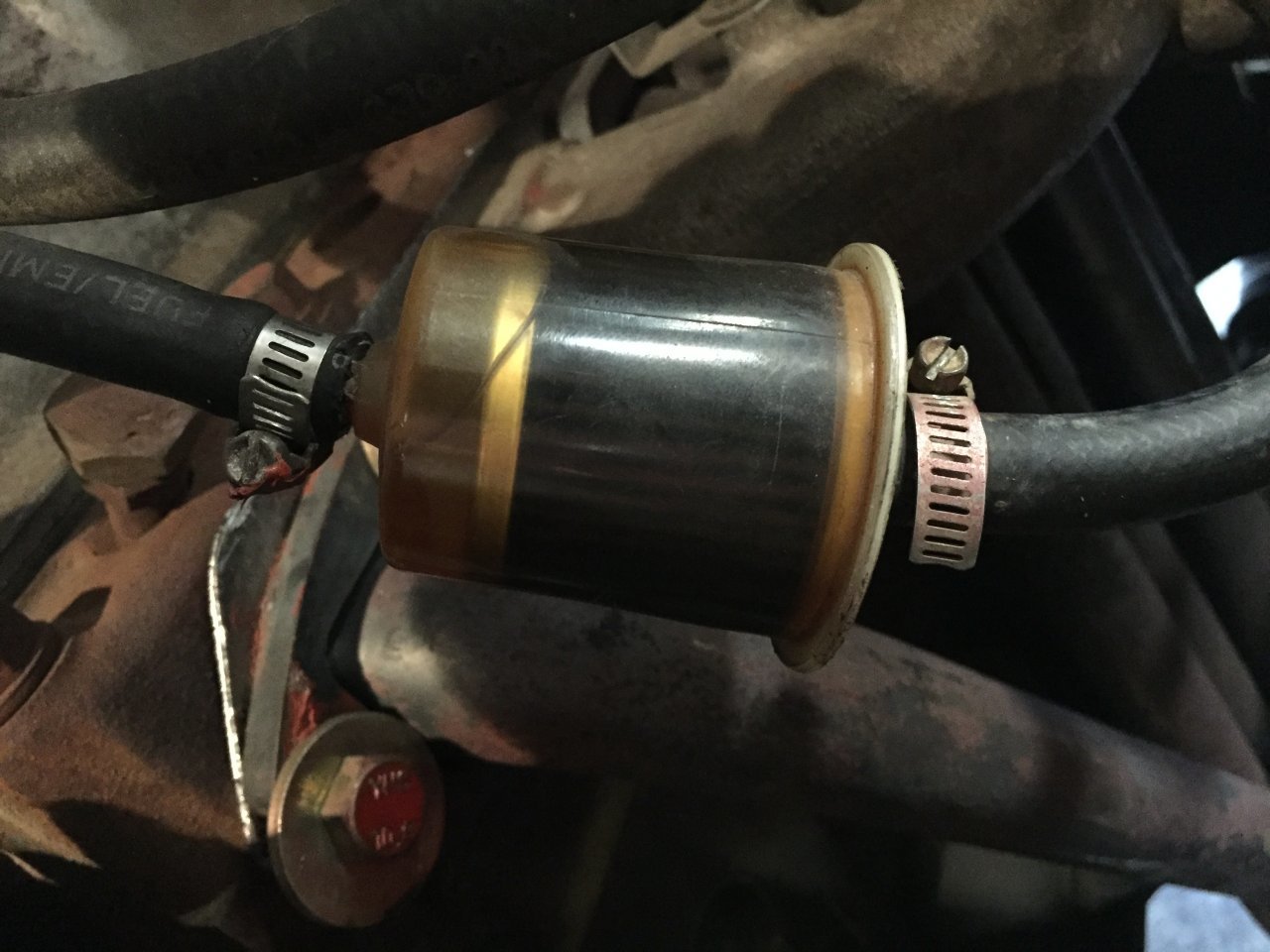

    I may be wrong but from what I’ve read, 2nd gen did not come with an independently replaceable fuel filter, such as a $40 canister elsewhere on the truck that would be replaced on a service interval like other cars that have it, as maintenance
    but rather a mesh weave bag integrated into the fuel filter in tank
    If that is the case I wouldn’t even call that a “built in filter” as it’s not replaceable, probably not enough, and every fuel pump has that, with a separate canister in addition to it (that the 2G doesn’t have)
    if that is the case, I’m curious if one can be added
    Simply cutting lines to splice one in
    I’m guessing any low pressure filter would be compatible
    the only obvious differences I’ve seen is differences in price reflected by ports on the filter
    -car with separate regulator at engine use cheaper filter with less ports
    -car without regulator has it built into the filter making it cost more, with more ports

    OEMs on a separate fuel filter generally spec 40k mi interval
    def possible to add filters if it works right
    Folks add add oil and fuel filters to diesel
    last car ran an added P/S filter (inline Magnefine), going to add the same to the truck
    a cheaper non regulator filter with just inlet and outlet ports would probably work
    after ensuring whatever connection method used is strong enough for the lines to stay on under pressure
    might work to find a spot, cut lines, add quick disconnect fuel line fittings on the hoses secured with ear type clamps
    according to Google pump on pressure is 38-44 PSI
    https://4wdadventurer.com/4wds/land-cruiser-build-fuel-pre-filter/
    apparently 22RE pickup comes with one and crimped lines with banjo bolts
    sounds like overkill to handle the pressure and possibly old tech before quick connect came out, harder to change
    then again the idea is reliability and banjo bolts to replace crush washers using a wrench sounds more reliable than quick connects that need special pliers and break from being plastic

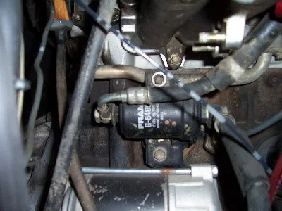

    This was for their 1GR. I have posted a photo somewhere on this forum, long ago.

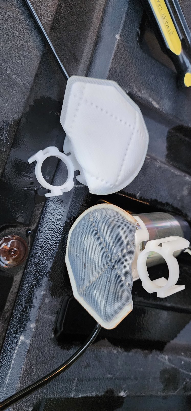

    Finally changed the fuel pump today. The truck runs so much more smoothly and responsively at 240k miles.
    Ordered denso fuel pump kit for $145 from Walmart.com. The socks which acts as a filter is on the other side of the white plastic unit.
    Tried doing this by removing the truck bed, only to have 2 of the bolts head get stripped. Decided it wasn't worth the frustration and changed plan and removed tank from underneath. It took about 6 hrs as it was not easy taking off the quick connects and also removing the gas tank bolts. In reinstall i was not able to get the rear tank belt bolt tightened fully. There is still a gap between the belt and the bolt that i will need to correct. Checked for leaks after starting, going on the road and adding some gas. Everything good so far.
    For comparison there is a pic of the old and new sock. The gas in the tank actually looked fairly clear. So not a question of bad gas. Clearly a bad pump.20240101_172529.jpg
