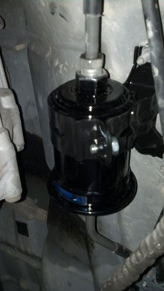

    Use flare nut wrenches, and take your time and slowly bend the lines gently until they release the filter. And take your time carefully starting the threads when you put them back on.
    Buy a filter that includes the mounting bracket.
    This is the OEM part # (assuming you have the V6, don't know if the I4 is different, I doubt it).
    This is what came out of mine.
