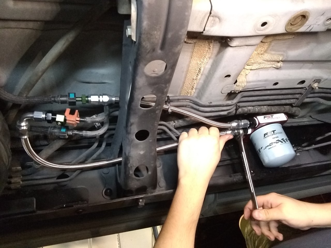

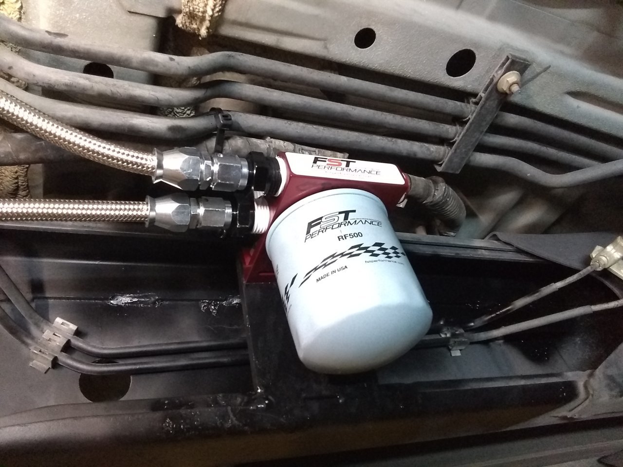

    Direct drop in replacements can be found on Rock Auto, much cheaper than factory.
    Or an upgrade pump kit can be installed for a potentially cheaper price. More labor intensive though.
    zippsub9 likes this.

    Would like more details on this. Price? Benefits? Skill level to install?
  11. Sep 16, 2019 at 9:52 AM
    Torspd
    Torspd Tor-nication
    Sep 18, 2009
    #22958
    26,337
    Tor
    The Great America!
    MMVI 4.4L 4x4 Access Cab
    Torspd Custom Turbo kit [] Borg Warner 9180EFR Turbo [] Haltech Elite 2500 [] TiAL Q BOV [] TiAL V44 Wastegate @ 15psi [] CP Pistons [] CP Carrillo Rods [] ARP Head studs [] ARP Main Studs [] ARP Header - Head Studs [] Ported Heads w/ 1mm oversized valves intake/exhaust [] Brian Crower Forged Stroker Crank [] Darton M.I.D. Sleeved Block [] Kelford Camshafts [] Torspd 160* T-stat mod [] APR Large Fuel Rail [] Walbro 460 LPH E85 Fuel Pump [] FueLab FPR [] APR T56 Conversion Kit [] KP RACING Built T56 [] McLeod Racing Custom Twin Disk Clutch [] One Piece Aluminum Driveshaft [] MGW Shifter [] Custom lowering kit [] Ohlins Front Coilovers [] QA1rear shocks [] Custom Ron Davis Radiator [] Dual SPAL Electric Fans []
    3 micron filtration. Keeps injectors happy. 20 second fuel filter change.
    About $300 for everything.
