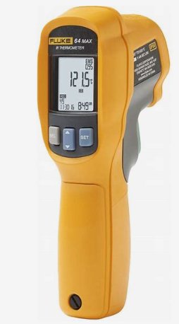

    I would bet a dollar to a donut you have a brake at one corner that is not properly bled and is constantly "braking".
    Get an Infrared Thermometer like shown below. Does not have to be a Fluke quality, Harbor Freight is fine.
    Scan the temps of your brake rotors (drums) the next time you drive. I bet you have one wheel that is 500F hotter than the other three and causing some serious drag. Thus killing your fuel economy.
    Doesn't take much to decrease the fuel ecconomy on a small 4 cyl engine in terms of parasitic drag.
