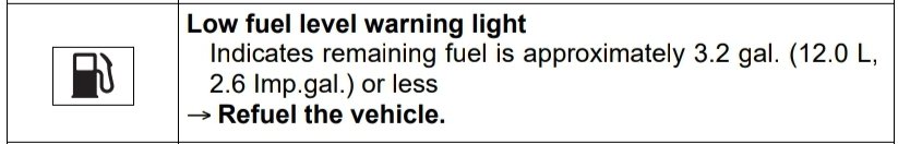

    When the low fuel light first comes on, you should have 3.2 gal in the tank (see clip below). One the light is on, I do my own math. If I'm averaging 20 mpg, I know I can theoretically make it another 50-60 miles.
    In my experience, the DTE gets to zero when there's 2 gallons left in the tank.
