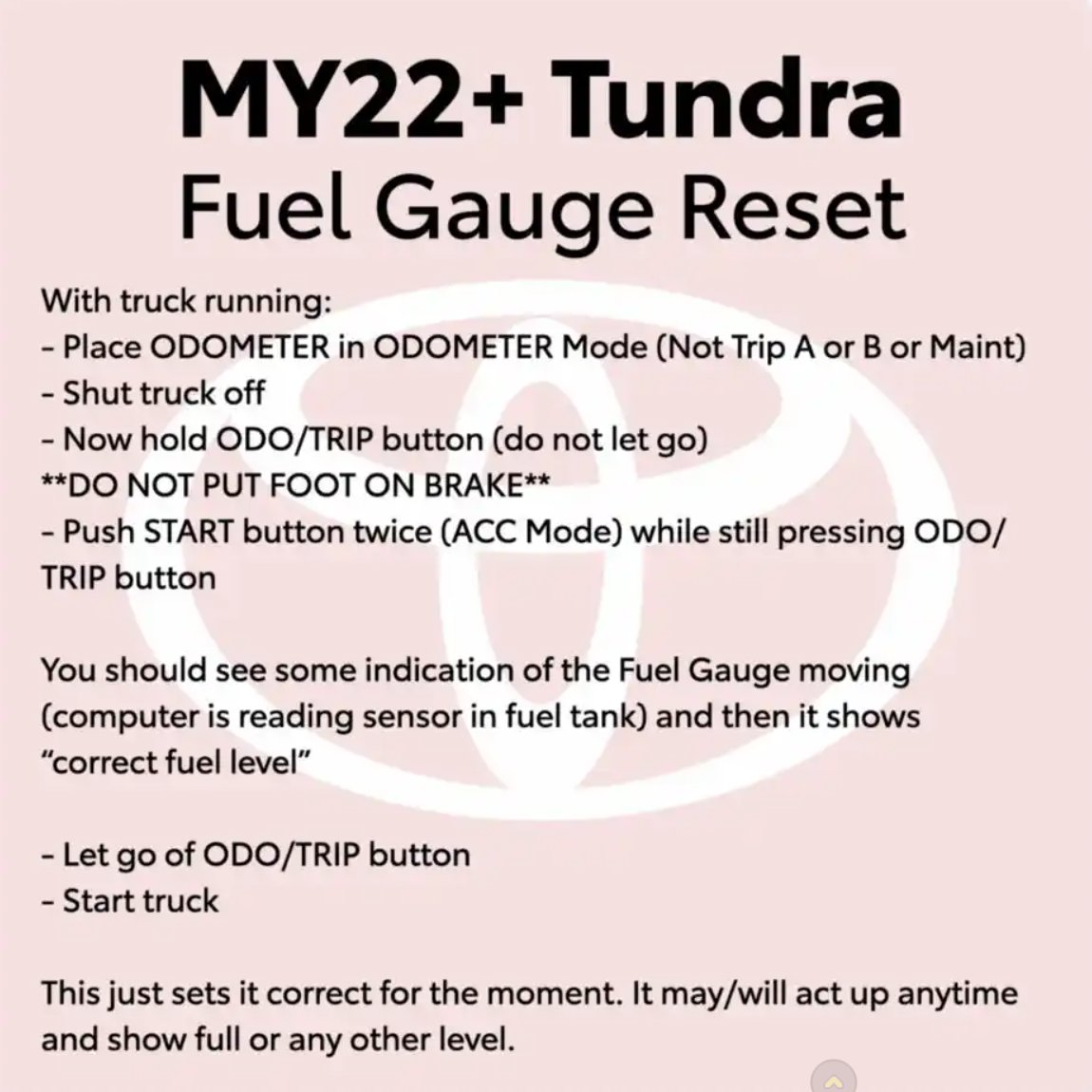

    here is the reset procedure for the tundra, maybe this will work for your tacoma.
    JB_TN likes this.

    The Tacoma and the Tundra have different reset buttons. I saw this before and it would not work with a 2024 Tacoma.

    um you still have a odo/trip button so the procedure should still work. otherwise how would you be able to swtich between trip a, trip b, odometer.

    It is not a physical button anymore. The ODO shows all the time and the trip is reset using the display. So the engine has to be on for you to see a trip to reset. You can't hold any buttons down in a 2024 Tacoma for trip.

    I tried the same thing. There is no ODO buttton.

    so how do switch from trip a, trip b?

    the procedure is on page 90 of the owners manual
