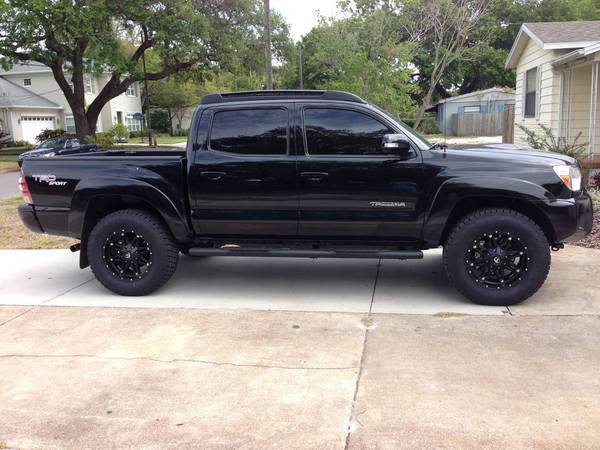

    Final result, Bilstein 5100's all around with Eibach coil springs in the front. 1.5" AAL in the rear with the Billy's set to 2.5" in the front.
    If anyone is worried about running 285/65 tires with a similar lift, by al means do not worry. The truck runs fantastic with no noticeable sluggish get up, rubbing, or increased stiffness. I couldn't be happier with the way this turned out.
