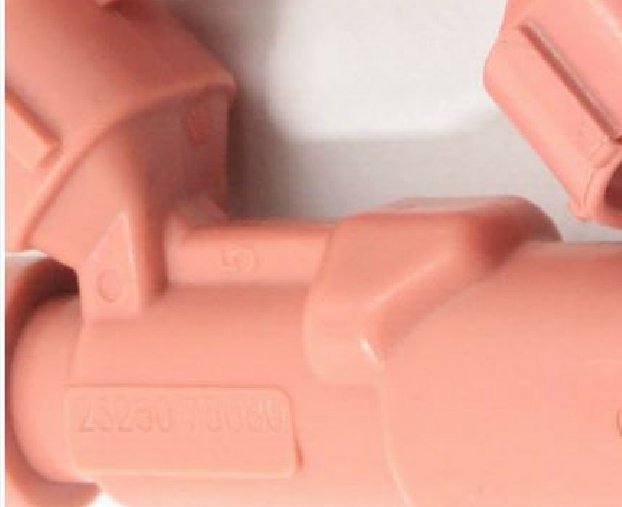

    Here's a post on how to spot counterfeit injectors.
    You need to able to see the side of the injector with the part number and look for the testing control lot number.
    https://www.tacomaworld.com/threads...cleaned-what-do-they-do.630582/#post-21617992
    I am not saying all pink injectors for sale on eBay are counterfeit. But I was able to spot these counterfeits. Note the information in the above link about how to identify counterfeit injectors.
    Let's be careful out there.

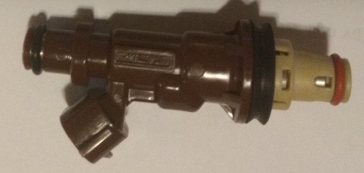

    I found this injector under that seller for the 3.4L Now let's compare it to a counterfeit from China that I just happened to have on hand. BRB

    This is too funny.. Real OEMs are made in Japan -- not the USA. Here's a picture of a made in China counterfeit injector. Notice the orange o-ring is placed on the bottom like the one in the picture. Also, notice the mold markings (circles) are identical.

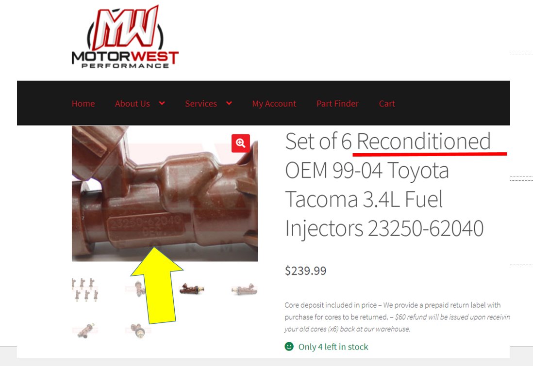

    Just to point out the injectors pictures on Motorwest site have the actual marking from an OEM injector. I agree the injector in the picture looks like a reconditioned (e.g. new o-rings, screens, pintle cap, cleaned and tested) OEM injector.
    The yellow arrow in the picture points to the original testing lot number from Aisan.
