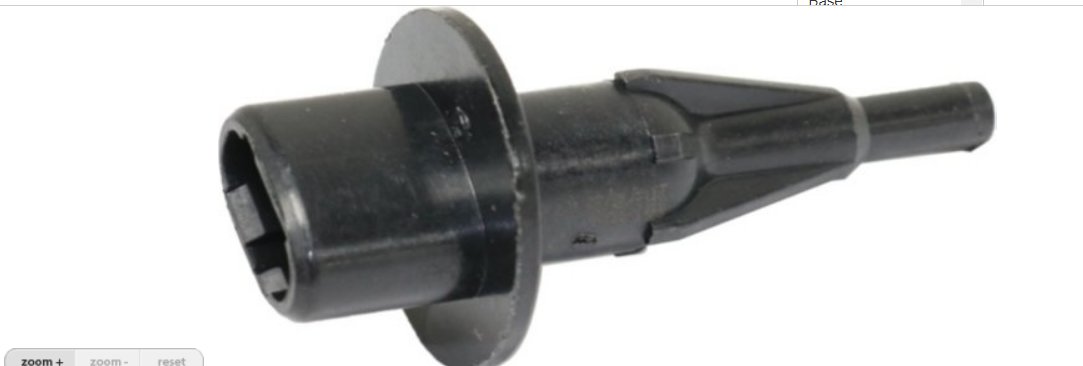

    I have a 1996 Toyota Tacoma. I am the only owner. Since about 6 or 7 years ago, I started having problems with the fuel injector, causing long turnovers, eventually starting. This problem ONLY HAPPENS in the summer time when outdoor temp is upwards of 95°. I was living in San Antonio, now Tucson. Last year I was finally able to have the fuel injector replaced; 2 months ago, I had the starter replaced, last week I had the fuel pump replaced. TODAY, Aug 1, 2019 I was out doing my usual errands (stop/go) and AGAIN the problem arises. I was in 96° heat (not bad for Tucson) and I sat in the store parking lot for almost 10 minutes, trying to start the truck every couple of minutes. Each time it just turned over & turned over, no start. Finally I remembered an old tip from about 3 years ago; popped the hood and pulled out the "inlet air sensor" (the plug by the air filter)- the truck started right up!! What is the problem???

    Is your Taco a V6 or 4-cyl? Was this the part?

    Hello CS_AR. YES that is the part. My 1996 Toyota Tacoma is a 4 cylinder.

    Looks like a fairly inexpensive part. I can see how the ECU would become confused about the environment temperature if this part was malfunctioning. A malfunctioning part might tell the ECU it was cold outside when the temperature is actually hot. More fuel would be dumped on the engine causing a mild flooding condition if the ECU thinks the weather is cold and vice versa.
    I once bought a car that was throwing a code for this sensor. It turned out that someone had left it unplugged when they serviced the car. I just cleaned the connection and it has worked fine ever since.
