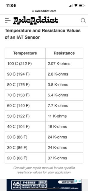

    Interesting
    Colder = higher ohms
    tested mine and reads 1.8
    Multi meter set at 200ohm k
    It’s 78degrees in garage now
    per the chart if 212degrees should read 2.0 ohm k
    so sensor reading like it’s 220degrees when it’s 78degrees outside
    guessing here
    when engine hot sensor would throw a ‘less than zero’ reading….and ECM just can’t decipher the negative reading and no start issue occurs?
    Hmmmm
    I hate throwing parts at a problem without 100% confirmation, but for $15…..I’m going to try
    I’m I totally off base here?

    I’m just asking if my ohm reading diagnosis of my IAT sensor holds water
