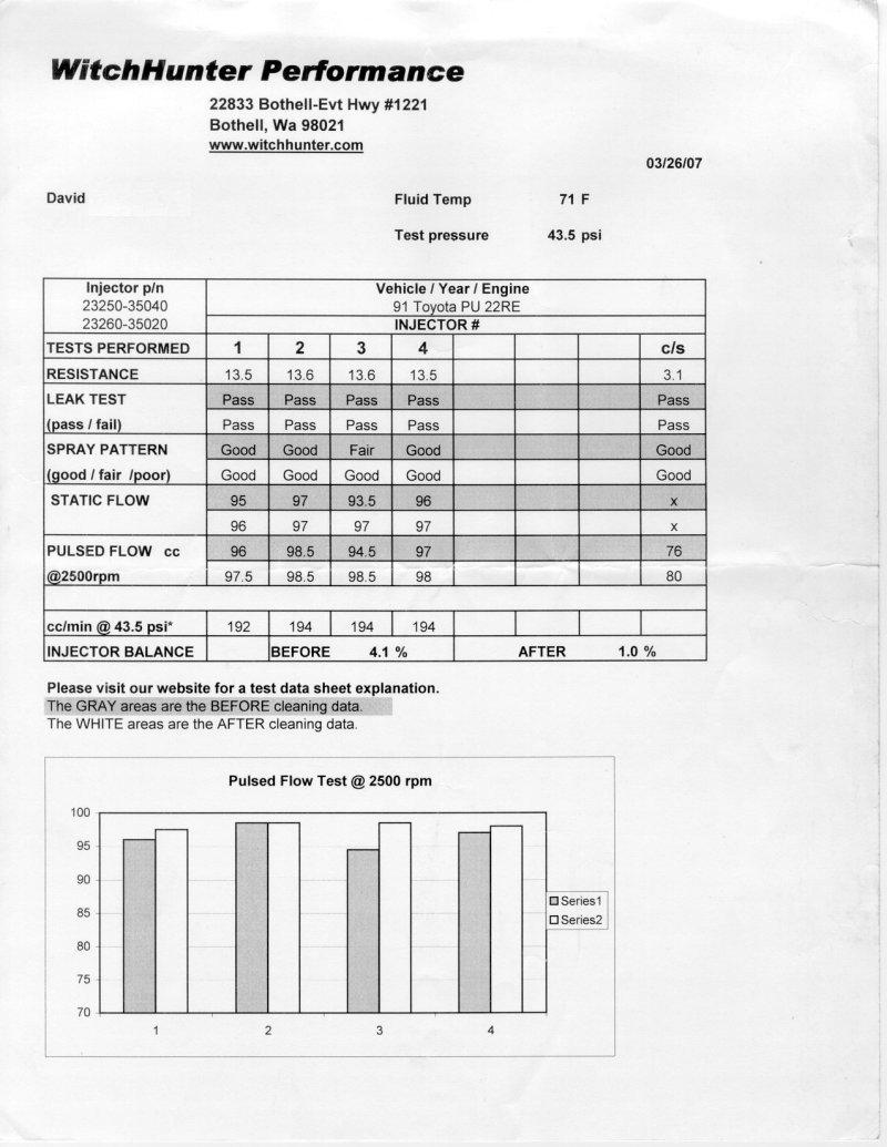

    Whitchhunter is back up 30 days it says right now, is the ones off of Rock auto plug and play no changing the connectors ?

    So ur saying witch hunter did you a good Job

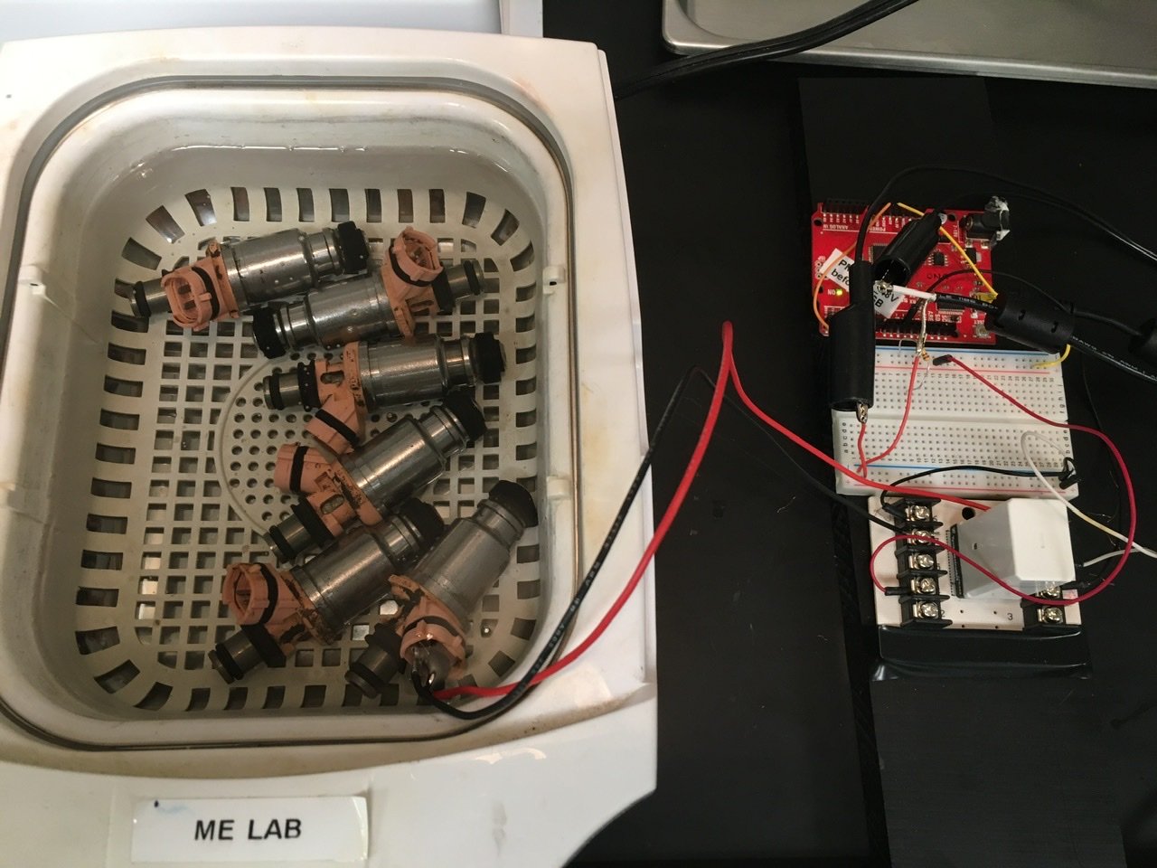

    Witchhunter does what they say. What I'd suggest is that you can do just about as good with a battery or power supply, some carb cleaner and an ultrasonic jewelry cleaner.
