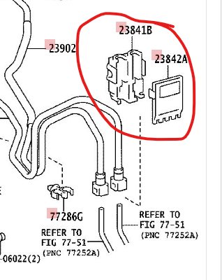

    Got a picture? I'm guessing those are the clamps that connect the engine fuel lines to the chassis fuel lines. Also, it's a returnless system so those are both supply lines.
    Edit:
    This?

    Won't know the issue for sure until you have a look. I didn't have any luck finding the o-ring identified separately, my guess would be it's part of the engine side fuel line assembly. A dealer with the electronic parts catalog would know for sure.

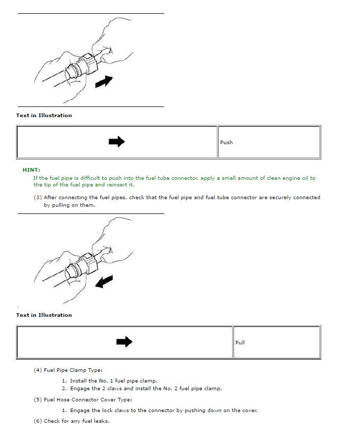

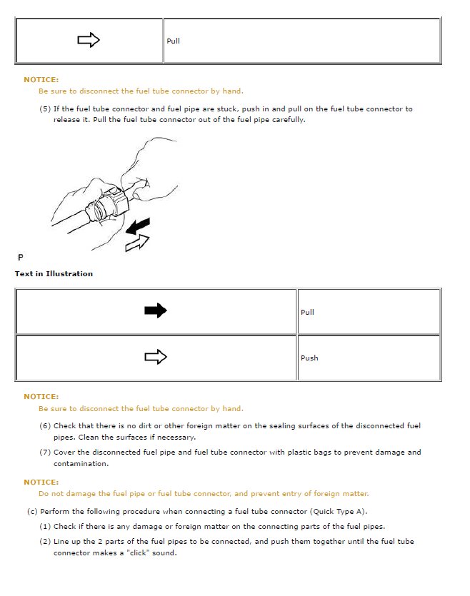

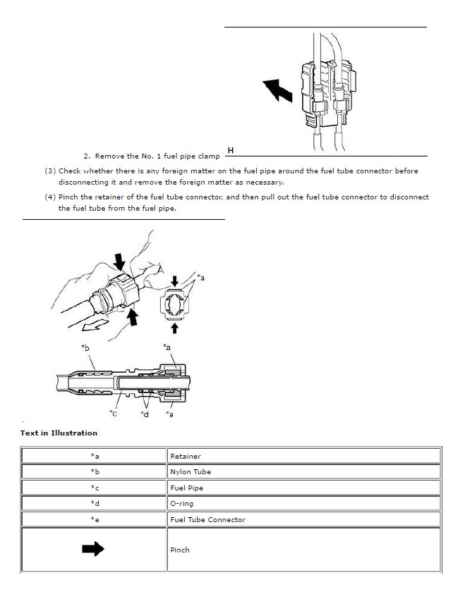

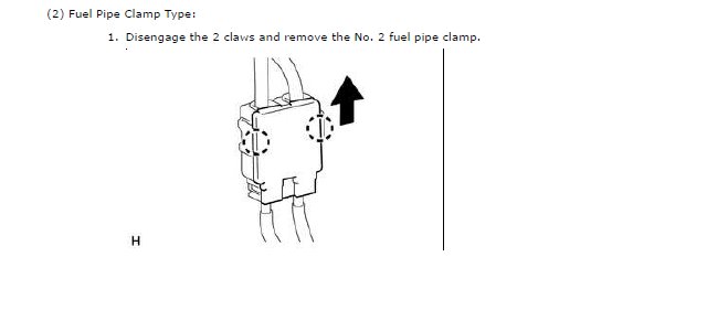

    Just took a moment at lunch to go look at it. Pulled the protective box off and pushed the hoses together with the engine running and the leak stopped. Watched it for a moment to confirm. No leaks. I'm definitely going to keep a close eye on it for a while. Thanks to both of you for the information, especially you Matt. Those diagrams helped tremendously.

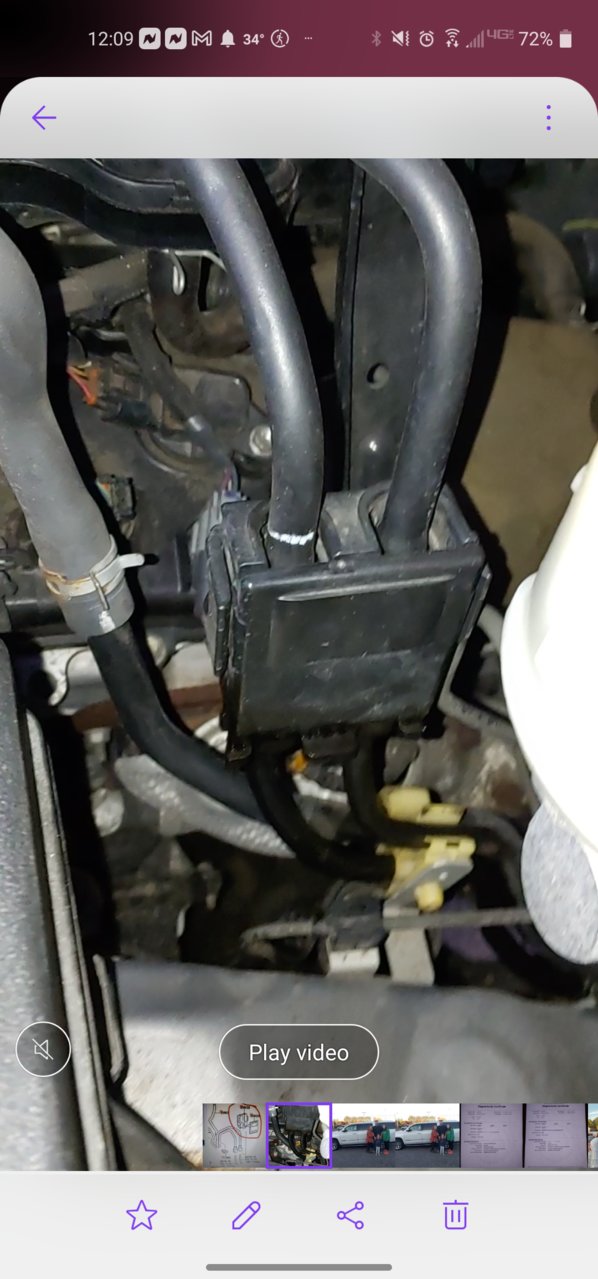

  12. Dec 3, 2022 at 9:11 AM
    surferbear
    surferbear [OP] Member
    Dec 3, 2022
    #412207
    7
    Turner
    2016 Tacoma TRD Silver
    No Mods
    Best I can do at the moment from my phone
