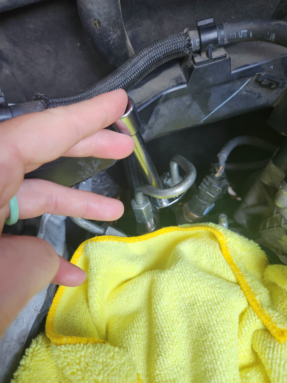

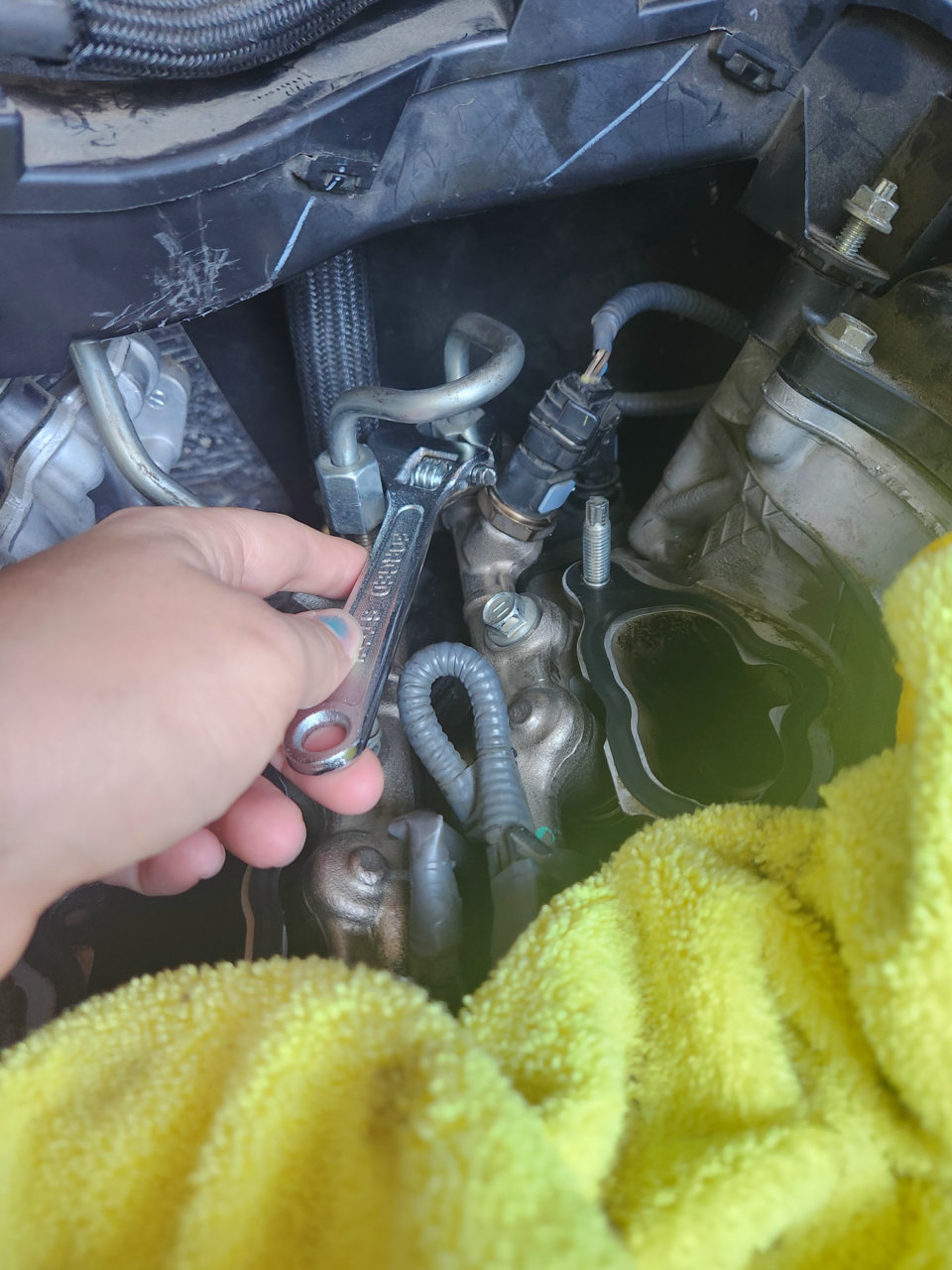

    Thanks alot for all your guys help. I'm feeling super defeated at the moment. I'm not able to loosen that other flare nut, that sensor is in the way. I'm using an adjustable wrench not sure if thats okay. not sure what to do at this point. Take the whole thing off? But then there is that other line ‍

    Don’t use a adjustable wrench. Do you want help or tools loaned? May be some Tacoma regional members near you to help. The San Diego crew has a lot of good members.

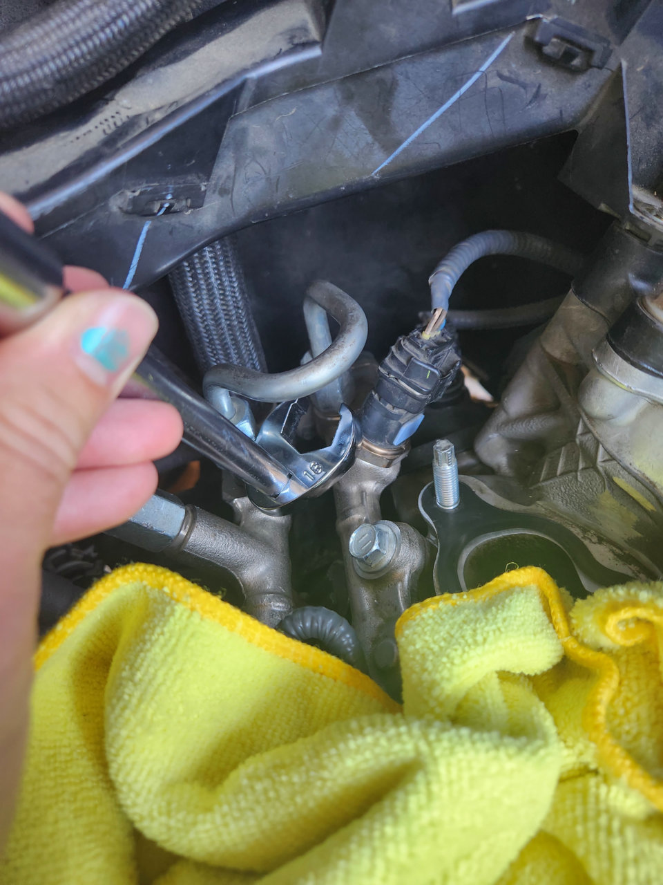

    You can see the wrench is hitting that sensor! :annoyed: what do I do ?:confused:

    do you have any metric wrenches?

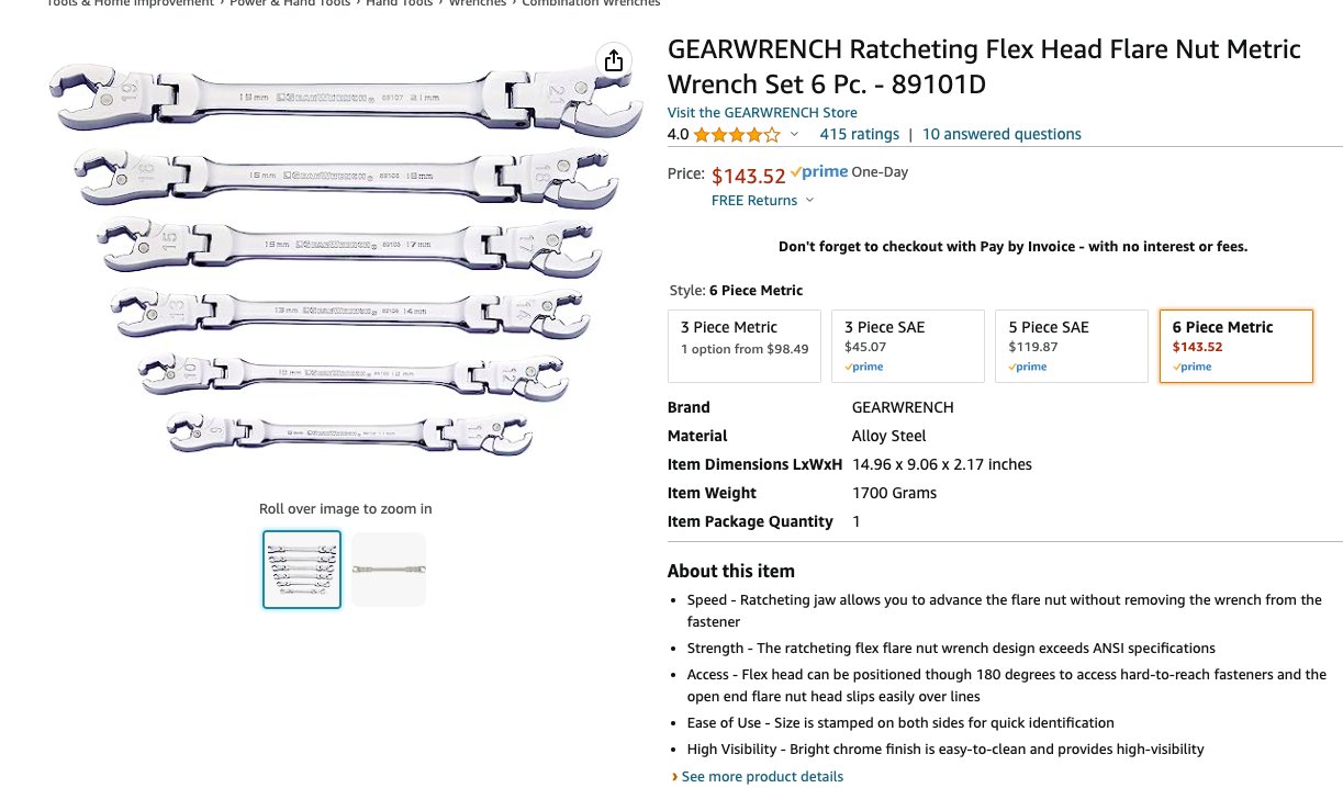

    A “gear wrench” with a flexible head could clear it- but they’re expensive. Maybe someone can loan you one? Some autoparts places like O’Reileys loans out tools. You could perhaps borrow one from a local member?

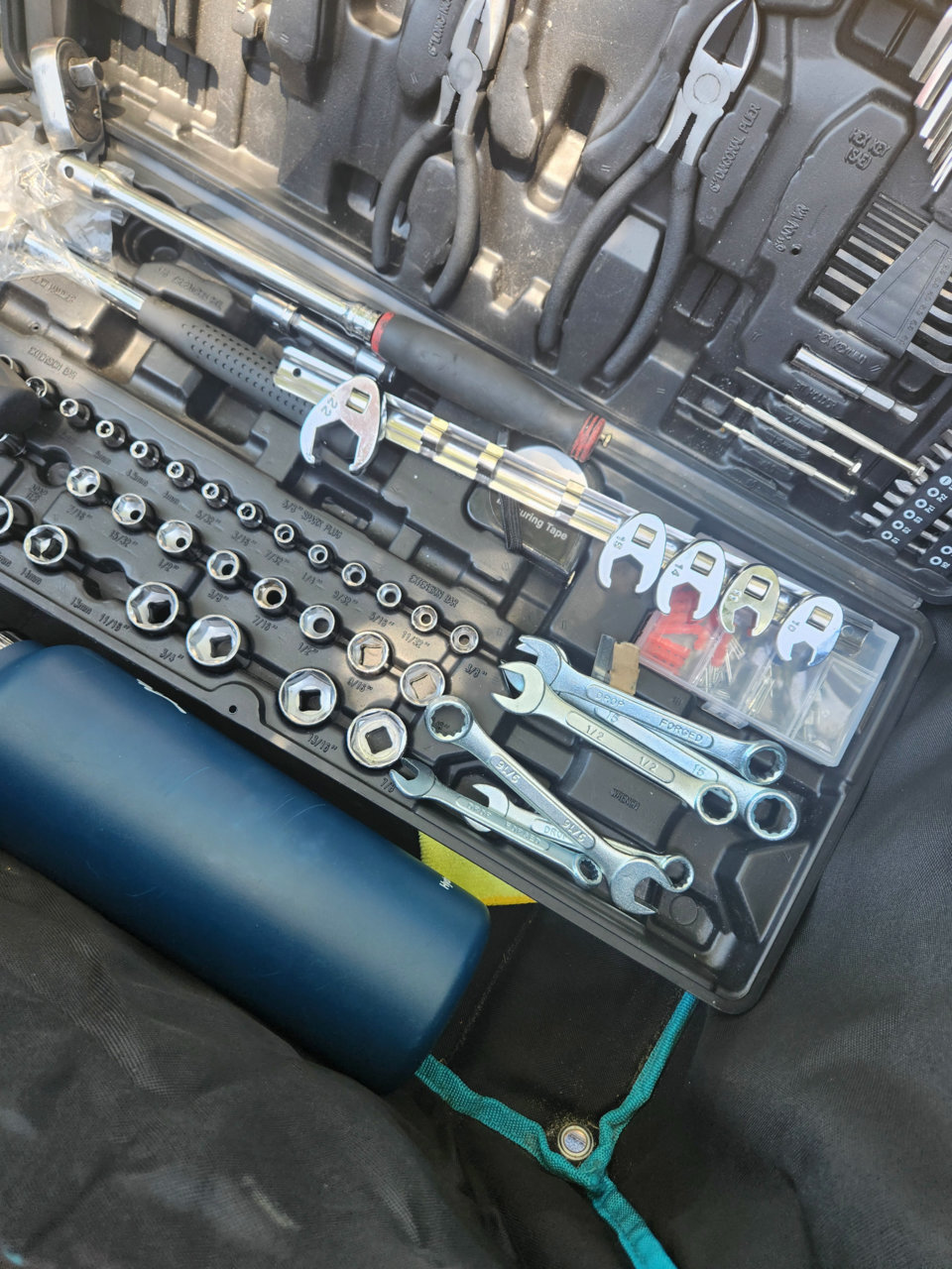

    I have these it's what I got from harbor freight

    ok...you got crow foots they will work if you have the right size...

    Yes but again that damn sensor is in the way. And that harness near the firewall? Is also in the way.

    put a extension on it....you know which ones im talking about?

    You could unplug and unscrew that fuel pressure sensor. Just make sure if it has a sealing washer or dope/tape on the threads you replace that when you screw it back in.

    That second photo looks like your on it enough. Stick your ratchet on that and see if it will back off. You don't need to unscrew it all the way just enough so the other side will line up. Then put both sides of that pipe on hand tight and snug them with a wrench after they are hand tight.
