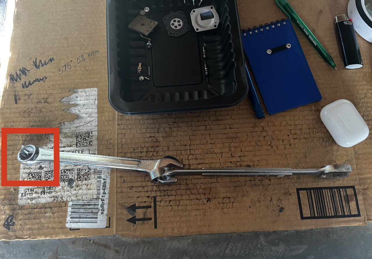

    The East Los Angeles way:
    I’ve used a grinding wheel in the past to lessen the width of wrenches to fit in tight spaces and give just enough room for clicks. You don’t want to take away too much material, just enough to hold without breakage.
    I would also recommend an open end wrench like others have suggested. Then use a “breaker bar” technique on it. You’ll need a wrench with two open ends (noted by red square-I did t have a wrench with two open ends). One has to be 22mm. The other open end can be 21/23mm. You’ll then use the 21/23mm side to accept another wrench as a breaker bar. You can use your left hand to stabilize the open end wrench on the nut. Mechanical advantage.
