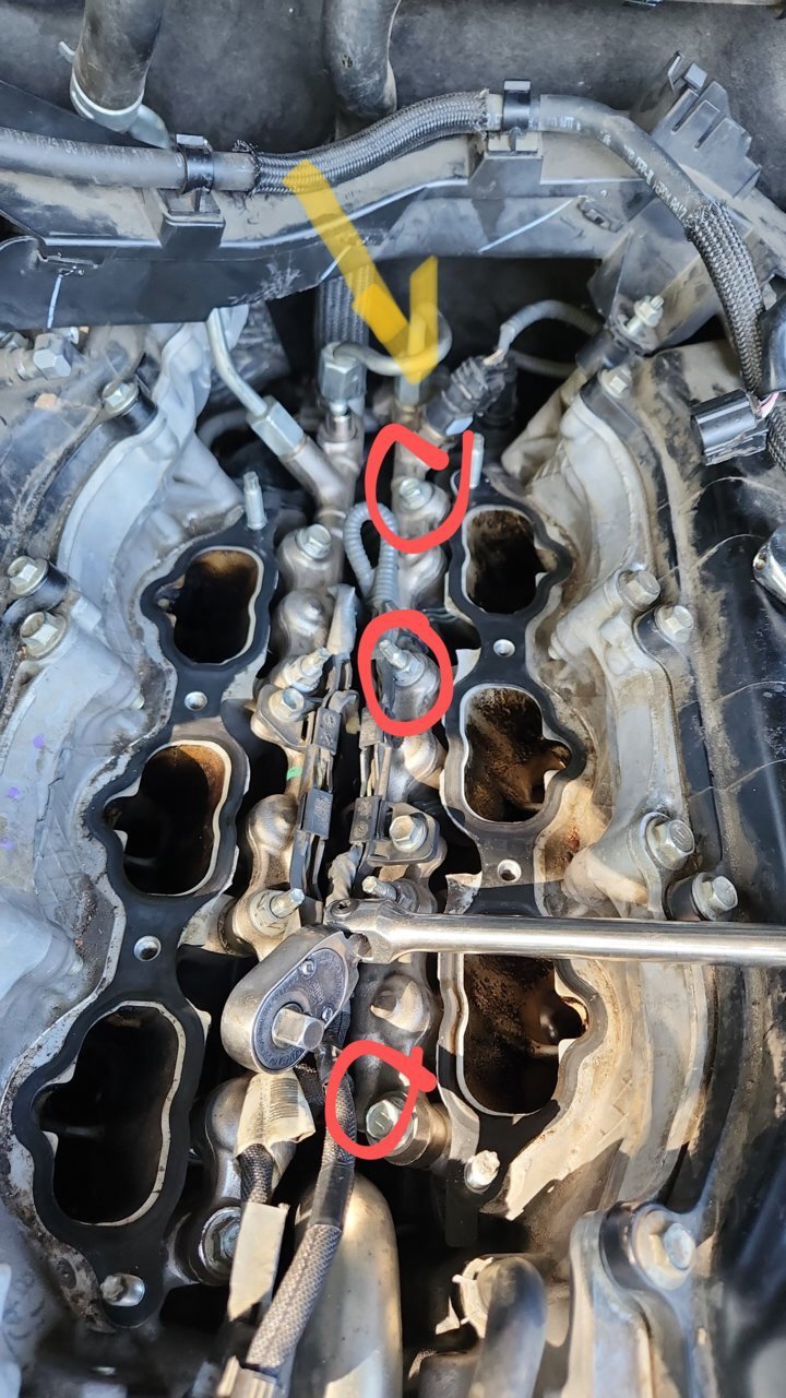

    I had put it together like several times. Then when I thought I had it done I found that leak :(

    Looks like the line got bent a little. Try to get the line straighter before threading it down. I would loosen BOTH and slowly thread them both down at the same time.

    Yes… just loosen them up on one side first,then see if you can start it..if not go ahead and loosen the other side to

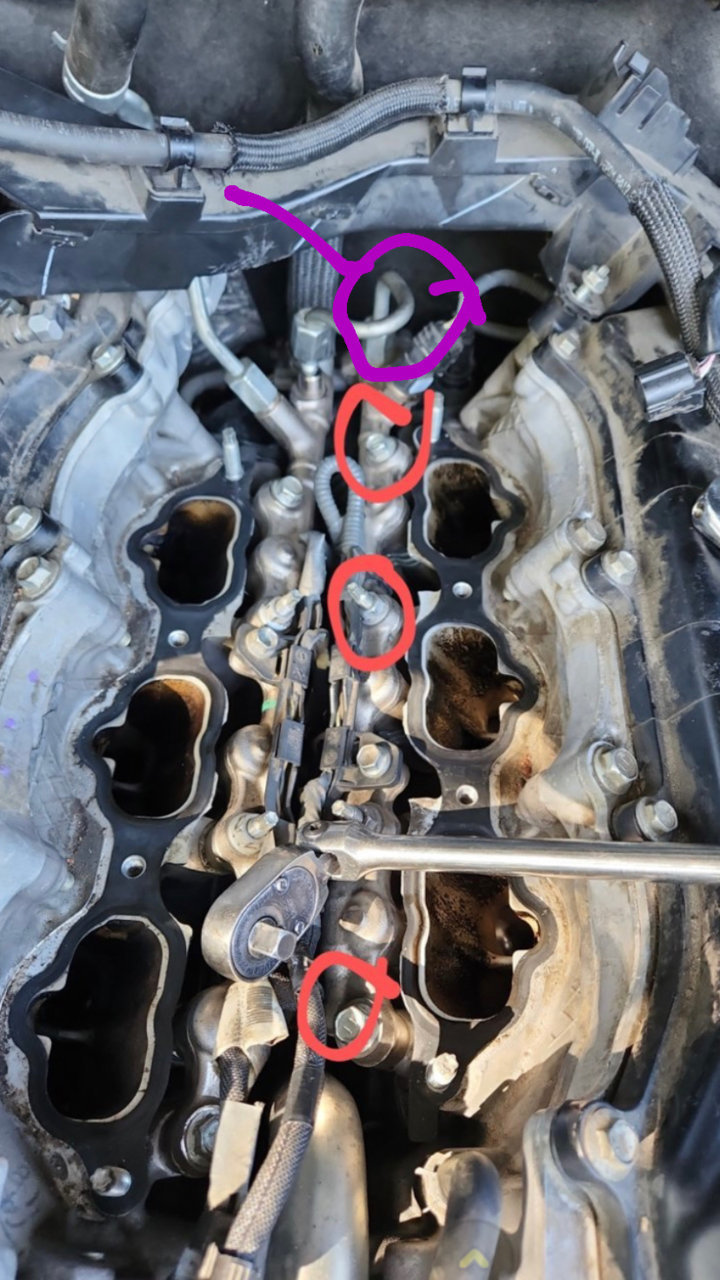

    Unless in looking at it wrong. Is this the other end of that I-shape line?

    No way I'd be loosening the rails to fix this. The line is so close to falling into place. Take the adjustable wrench and tighten it onto the line by the fitting and gently tweak it into place.

    No loosen this side

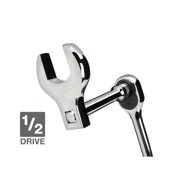

    Are you using the crow foot wrench? If so that’s why. Gonna need to use a a regular wrench or adjustable wrench. Remove that sensor to give yourself more room.

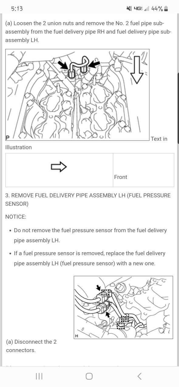

    So I initially I was using an adjustable wrench I was told not to use that to loosen the flare nuts. And I cannot remove that senor per the manual.

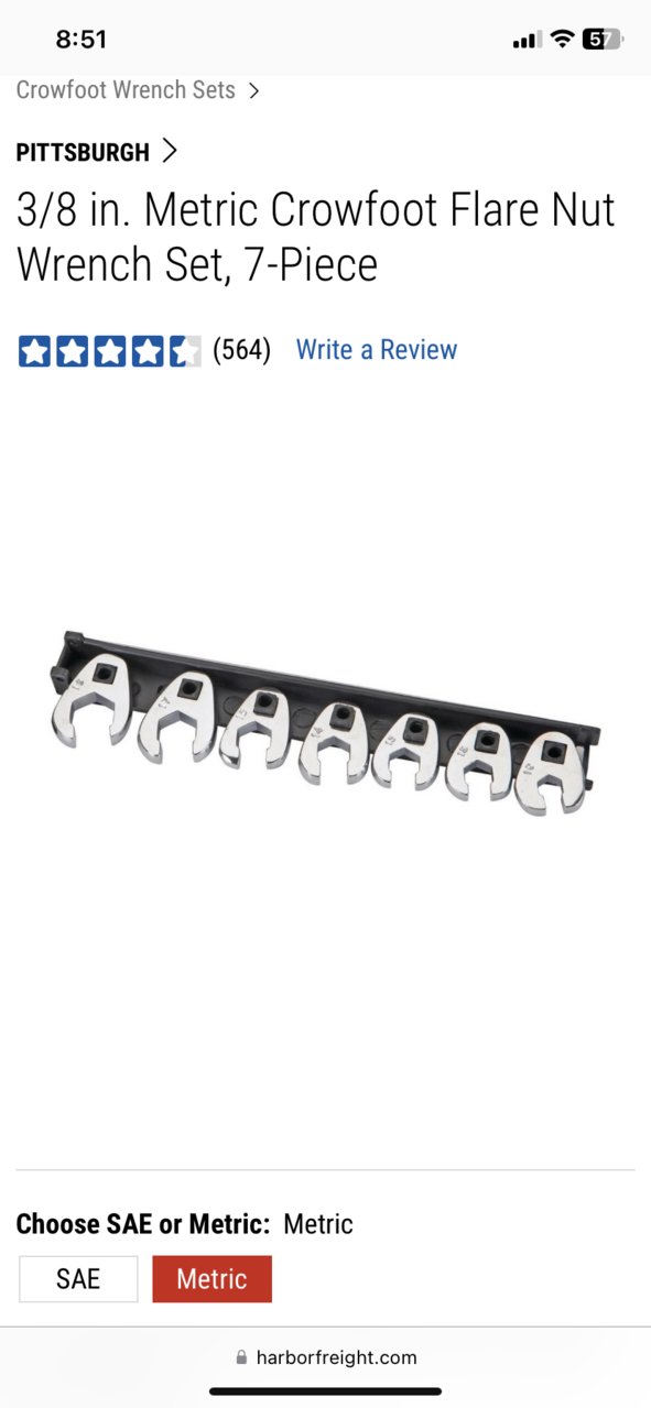

    Use a crow foot wrench like this and you can use an extension and a ratchet which will give you more leverege
    Harbor freight.

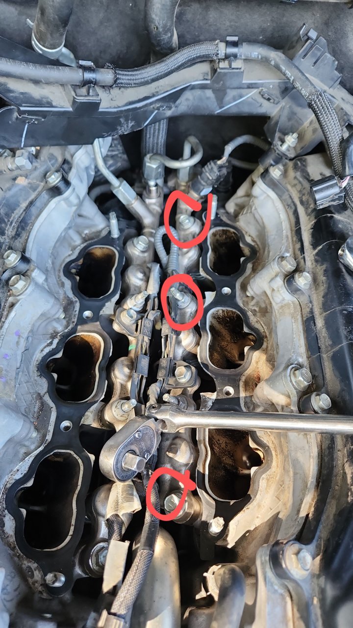

    Like so. Might help you

    Haha this is what I have been using. I can't get it to loosen at all. Either I'm a little bitch and can't it to move or im a little bitch who can't it to move hahaha
    Seriously though I feel like im gonna break something and then I'll be super screwed.
