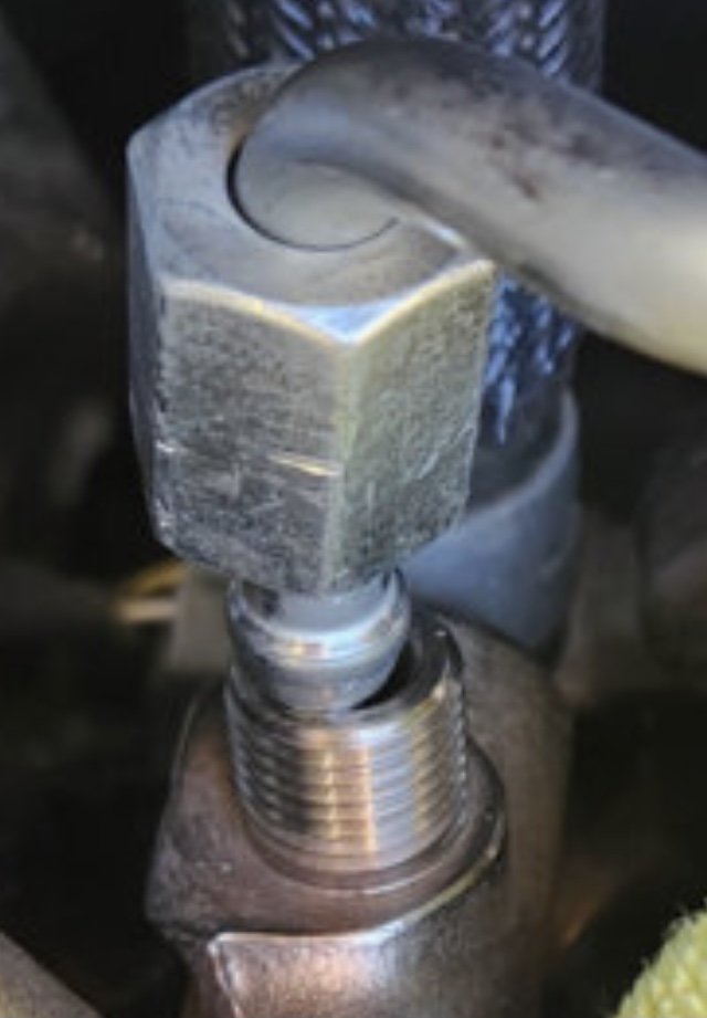

    I think the fitting is stuck at the corner of the fuel line. Maybe a slotted screwdriver twisted between the fitting and fuel line will release it.26AB020E-28DD-4052-AE9D-3B3619484182.jpg

    You need someone to push down hard on the fuel line while you attempt to tighten the fitting. Make sure the fitting looks perfectly straight to the threads, any resistance and stop. maybe a bit of lubricant on the threads? IMO
