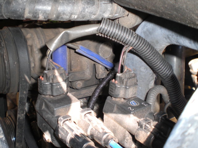

    For the coils......pre 2001......

    One plugs in my cruise control....and the one on back engine that goes to ect....just under the harness mess out of fire wall.....
    Lastly IAC and MAF ones......

    Dude, you are golden. That should be in a sticky. I sure wish I had had that when I put mine back together!
    I would advice anyone taking one of these engines out, and planning to put it back in, to mark these plugs so they can be mated back. I thought I could wing it. For most, I did. But most isn't good enough. They all need to work. Thank you O'Silver Taco!
