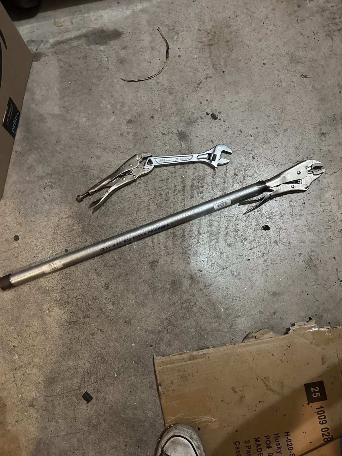

    Hands are bruised,
    Ego is shattered,
    The nuts fucked
    BUT THE HOSE IS OFF

    Holy Shit!!!
    Great job
    Have a beer(and shot) you deserve it
    freakin cheater bar??????
    You did go Medieval
    time623[OP] likes this.
