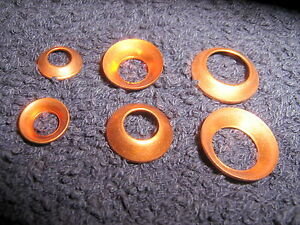

    Little hard to find but I use these on all double flares that are old and fragile...that I have to reseat.....
    usually, one auto zone in the city will stock em...
    None of em have leaked in ten years of using....
    they're rated for 200+ psi hvac service,
    so 45lb fuel pump shouldn't be nothing...

    Another way to ensure a seal on that connection is exactly what I have wanted to find.
    I’ve never used anything like that before so just to make sure, these are installed by dropping them into the female hose connector, concave side facing out(concave side to fuel hardline), and then inserting the fuel hardline on top of it and compressing them together with the flange nut ?

    The concave side faces opposite the flare on the tube.
    The #8 I all ready had were barely too big.
    SO I had to get the next smaller size.......#6's
    Santech Washer No 6 Flare 5 Piece (autozone.com)
    these allow you to get leak free connections without having to over clamp questionable old double flares.......
    The replacement fuel line to filter and after filter fuel lines are $200 each.....you do not want to damage those seats on either.
    You can get these already compromised......if the previous mechanic wrenched down on that nut without the end tube being square on the receiver....
    creases or deforms the flare end on the tube......
    and reflaring 20 yr old steel tubing is sketchy at best.....it just wants to split.
