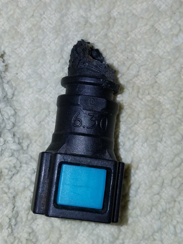

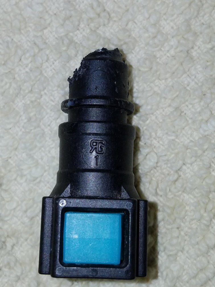

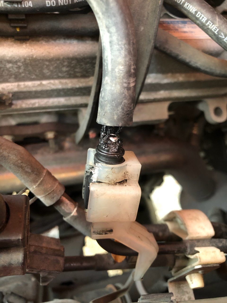

    Fuel line leaking - after examining it we found that some squirrels got hungry. Chewed on it pretty good. Appears that the damaged part is a connector between the steel line and the nylon tubing.
    Is this something we can fix or do we need to go to the mechanic?

    Probably need to source at Toyota.
    Looks like a special connector. It could be an integral part of the soft line.

    I think thats gona be the whole flex line that goes from the fuel rail on the engine to the steel line on the frame, should have a quick connect on the other end too.

    Unless doing a custom fuel line, that whole section of fuel line going to the fuel rail will need to be replaced. By an OEM part.
