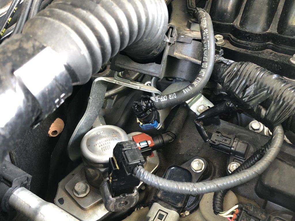

    I can’t seem to find out what this part is. I know it has fuel pressure on it as when I turn on the key the fuel sprays out of the part. The hose on it, in the picture says, do not kink. The top of the plastic blew off taking part of the rubber with it.
    Just trying to figure out what part to buy as the diagrams don’t seem to reflect this part

    I quickly looked on Sparks Toyota parts and see a bunch of hose and other parts under Fuel System/Fuel system components that are not in the diagram and I suspect what you need is one of those parts. You might have to go to a local dealership for more help.
    Unless you or someone was in there wrenching, it appears maybe you have rodent chewing damage, so I would look very carefully at the wiring and other hoses assemblies.

    I do have squirrels but I discount that theory as none of the wiring or anything but the top of the plastic assembly is affected. Unless the squirrels were huffing gas.
    still a valid thought thanks

    Definitely not a recall as I called Toyota and the recall is for the fuel pump.
    The consolation to all this is they also can’t find it on their part diagrams. I sent them a picture and turns out they have a truck like mine in the shop so they looked at it….and are stumped

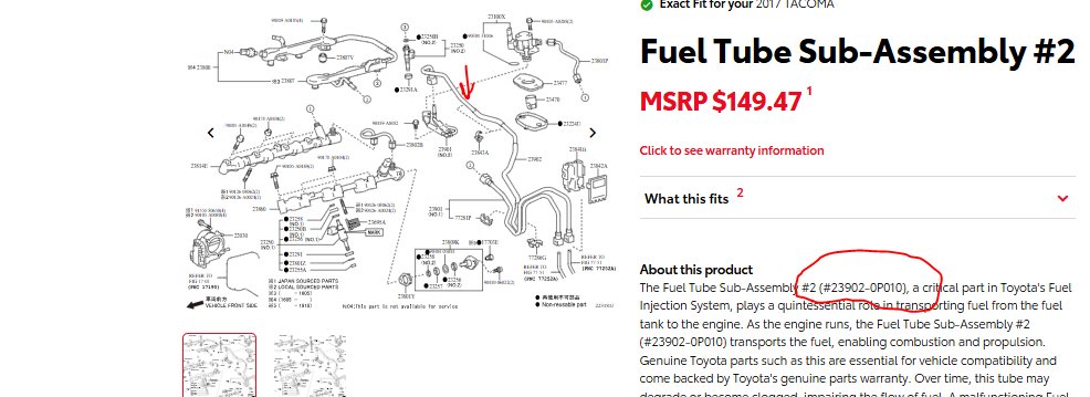

    you need No2 fuel tube
    you won't be able to find just the connector.

    Yes I ordered it from the stealership for $175 but it won’t be in until next week.
    Amazing you figured that out. Took the parts guy 20 minutes AND they had a truck to look at in their shop. Plus they said it was their best guess they weren’t 100% sure.
    Appreciate your time

    Toyota says there isn’t a single fuel line in stock for a 2020 Tacoma in the entire USA. They ordered me one and it has a 95% chance of coming in on the 10th so I am hoofing it.
    The issue is, in my opinion, if you make a part for a vehicle that can’t be ordered anywhere else maybe you should stock a few in an entire country.
    I will be putting JB Weld on the 90 degree plastic part for additional strength when it comes in. The design may be one of the worst I have ever seen. A plastic piece running 50psi can’t last with a 90 degree bend. Every time pressure is applied it will flex slightly until it breaks.

    Anyone know of a tutorial for say changing injectors on the 3rd gen 6 cyl for a Tacoma?
    I was hoping I could get to the connector but unless I am seeing this wrong it’s connecting under the intake manifold in a locations strategically located out of sight. It appears I may have to remove the intake manifold to squeeze the connector and release the fuel line
    It’s my duty to inform you….you are correct. Once I got it off so I could examine it in sunlight yeah….it was a squirrel chew toy. I examined everything else under the hood and found a set of wires on the intake that has also been slightly chewed.
