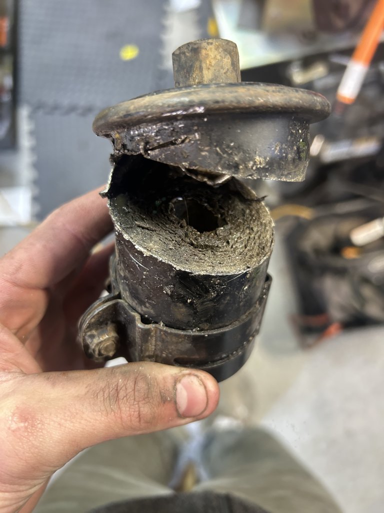

    Im understanding what your saying. In my case, I had good fuel pressure as well. ended up buying a filter with the LBJs I went to the dealer for. I did notice a change in fuel economy, and also a pass of injector cleaner did much more than it typically would have after. My filter was long overdue, but if it hasn't been done which Mark didn't say in his post if it has or not, it should 100% be checked/replaced. Again I'm sure it varies on situation

    The 4.0 doesnt have a canister filter like that. It has a fabric “sock” that wraps around the pump intake.

    well that's pretty dumb. can you even access the pump without dropping the tank?

    No, but it’s not a maintenance part, so no need to access it. It’s not fine enough to get clogged.

    that's filter isn't reflective of the OPs filter design and most modern vehicles.
    how many filter issues do you read about on here? Almost none, almost the entire industry uses in-tank filtration for gasoline vehicles and it's made the majority of fuel filter issues a thing of the past.
