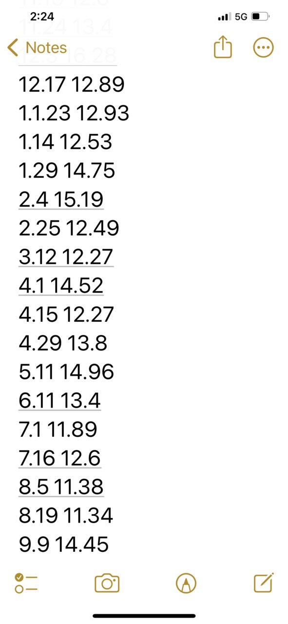

    On mine, what made the most dramatic change in mpg is putting a new air filter in. It wasn’t that dirty, so it looked. It had been a couple years, maybe 8-10 k miles and I had a new one on hand so what the heck I figured.
    Not driving with a lead foot also makes a difference. This is a habit I just can’t seem to break. So I regularly get 11-12 mpg. Every once in awhile a little less or more.
    The times I got over 12 is usually because I drove it on the freeway.
