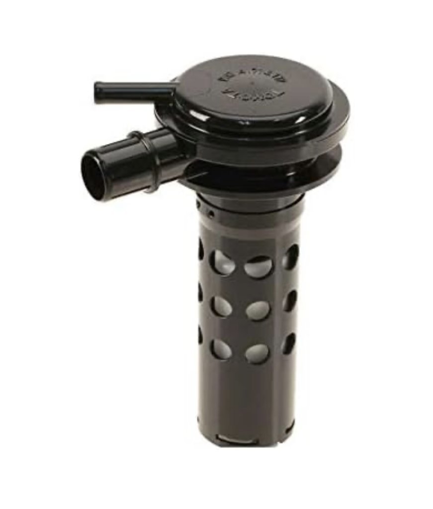

    The more I think about it, I think everything is pointing towards your charcoal cannister.
    The workaround of filling the tank with the nozzle upside down to avoid the nozzle clicking off (from vapor backpressure) has likely been saturating the charcoal cannister with too much moisture (similar to the way overfilling the tank would).
    Now the charcoal cannister is likely caked up and not letting the tank breath. And ultimately it may have been the fuel tank vent valve that started all the problems (that first caused you to have to fill up your tank that way).

    does the new charcoal canister include the fuel tank vent valve?

    Nope, 2 different parts. The fuel tank vent valve part # is in that thread I linked above.

    Isn't the system suppose to be under some pressure? I always heard a slight amount of pressure being released on fill ups. Now I hear no pressure but gurgling when the cap is removed and the P0446 code. Replaced the charcoal canister but still hear the gurgling and gas smell. Guess the roller valve is next?

    Be interested to know what a “roller valve” is! Can’t say I’ve ever heard of one!

    It’s also called fuel tank vent valve

    Ok my pressure was definitely not excessive and have never had an issue with filling the tank. New cannister already installed and new tank vent on the way. Hope this takes care of it.

    What are you trying to fix again? If you dont have problems filling up why do you need a tank vent? Are you smelling fuel while driving?

    No gas smell when driving, only when exiting the truck around the tank area between the cab and the bed. Codes P0440,P0446. Checked VSV and vacuum lines under the hood, good. Gas cap, good. No pressure when removing gas cap and just a gurgling sound. I've overfilled the tank several times, figured charcoal canister so I replaced it. All vacuum lines look good and no evidence of a fuel leak. Cleared codes and still smell gas. Usually takes 3 days to throw codes and I'm on day 2, nothing so far. Figured only thing left is the tank vent. Never had any issues filling the tank like you've stated.
