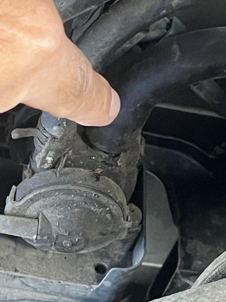

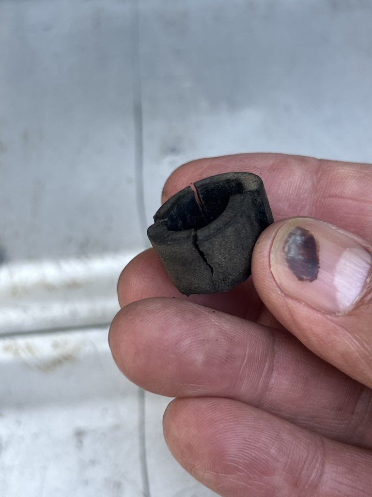

    Been down for a couple days after the latest Covid vac booster. Kinda made me feel shitty, anyway no exhaust leaks. Checked that out good. Doing an inspection of the charcoal canister I found I believe it’s the canister evap purge line was split at the end where it connects to the canister. I cut off about an inch of hose and reinstalled it. I’ll drive it later today and update my findings
