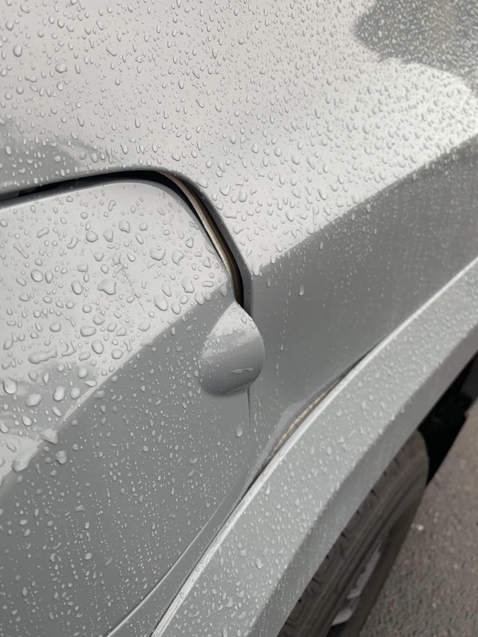

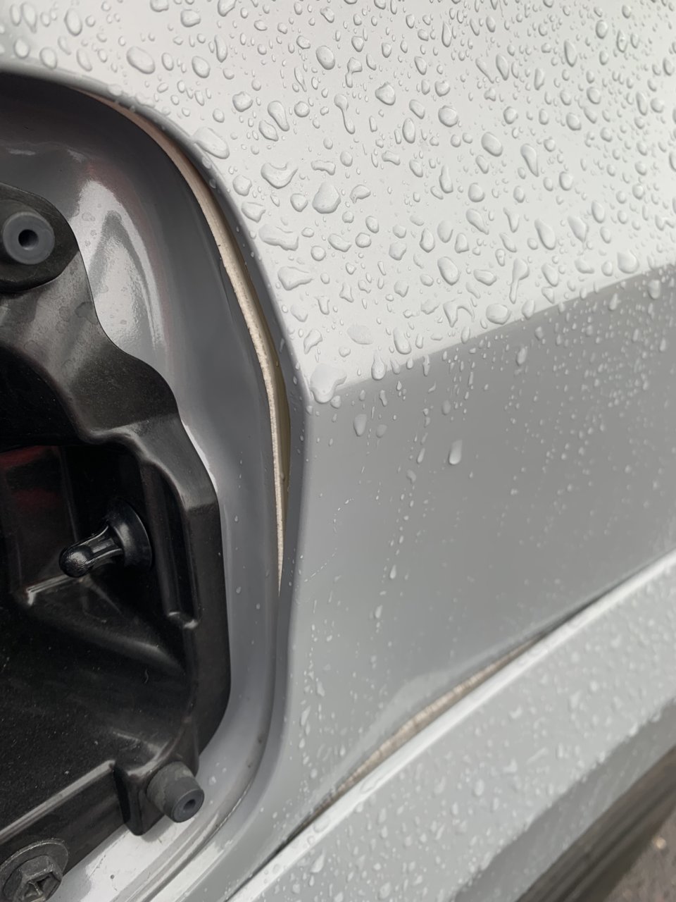

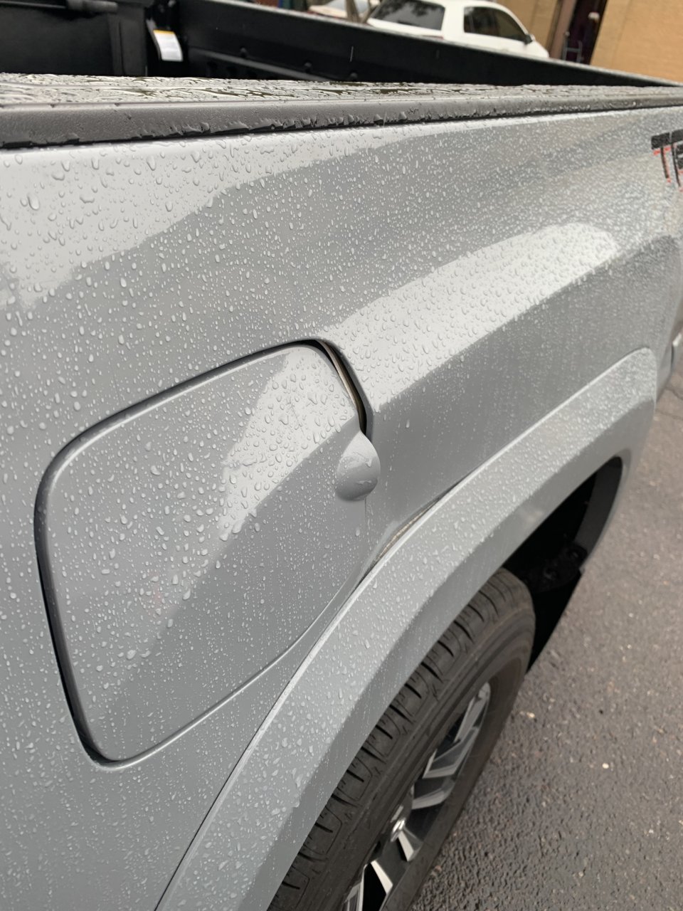

    Hey all,
    Someone this weekend slammed themselves or kicked into the my driver's bed panel right near the fuel pocket. There is a dent right above the flare and the seam sealer around fuel pocket is separate and now fuel pocket sits slightly inwards.
    Got it appraised yesterday at two places and they want $600.00 - $800 for body work, paint and fuel pocket fix. This seems steep to me as the dent could fixed with non paint repair since there is no paint damage. All that would need to be done is re-sealing the fuel pocket once the fuel pocket is pushed back in alignment so the fuel door closes flush.
    Let me know what you guys think. Pictures of damage below.
    Thanks!

    From the body shops perspective it is a liability to not fix it the right way with a re-spray. @ $50/hr is only 12-16 hrs work.
    Typically body shops offer a warranty with their work, which is rolled into their cost.
    from the damage in the photo, I imagine the gas opening flange will need some work to correct.
    It will likely need resprayed. Bending metal after paint compromises the metal/paint bond.
    With the fuel door being an high traffic / high risk area for impact and corrosion (fuel spill) re-spraying is the best option.

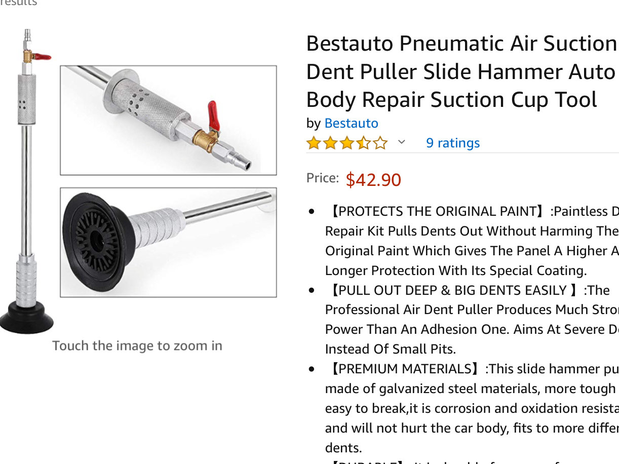

    I bought and have used this tool before. Works well as long as there aren’t any creases in the metal. Or you could try a paintless dent removal company before spending $$$ at the body shop.A4C1A422-A1FA-4769-9CC7-8F8DD97BC196.jpg

    Had a similar dent where the panel was pushed in. Called a REPUTABLE paintless dent repair company and they came out to my house and were done in less than an hour at a cost of under $100 and it looks as if no damage had ever occurred. A reputable company will let you know beforehand if it's something that can be fixed using their method or should be taken to a body shop. And the bonus is I avoided having to make an insurance claim. It's worth a shot before you go spending $500-$1000 and filing an insurance claim and inevitably having your rates go up for something that could possibly be fixed with a small out of pocket expense . Just my 2c
