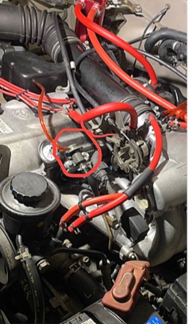

    -the FPR is on the end of fuel rail......closest to rad here.......
    there are vids out there how to test FPR....but part is inexpensive

    now i had 'hot no start' issue
    turned out to be injectors
    but tracking down issue and to make sure the original FP was not the cause
    i bought a FP gauge from LCE
    https://www.lceperformance.com/Prod...MIiLCl14jmhgMVIButBh0svwlqEAQYAiABEgJP1fD_BwE
    installed both the gauge and FPR at same time to rule out low FP from gauge
    original FP showed 46lbs running but pressure would drop pretty fast after shut down
    after RM'ng injectors at MotorWest in CA
    im good no issues
    46lbs running holds at 46lbs for 45m to 1hr after shut down
    (i do have a FP on stand by when it does fail!)

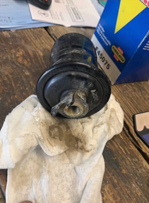

    yeah i found out the same here
    only primes when key is turned all the way and engine starts cranking.
    i guess you could test FP once the FF removed
    (and can find a fitting that works to the hose on FP gauge tool)
    dude my hands were not only gashed to crap getting that FF out
    hands were actually swollen
    glad i did thou

    oh sorry
    yeah both the gauge and FPR install took 10mins total
    LCE instructions say 'only meant for diagn purposes'
    i have under hood FP gauges on all my 3 old cars 98/96/01
    whatever....looks cool....my risk

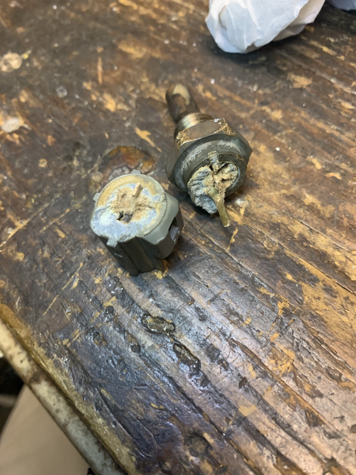

    In fact, the more I’m thinking,
    The coolant temperature sensor on back of the head might be your ticket to solving issue
    again mine……
  12. Jun 18, 2024 at 8:16 PM
    HillBilli
    HillBilli [OP] Active Member
    Feb 5, 2024
    #443212
    38
    I think you’re right! I couldn’t find it on my truck either.. and yea I was hoping that ECT sensor was the cause a little while ago when I changed that but unfortunately not.
