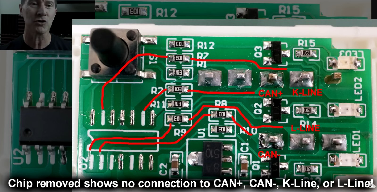

    Why would you blindly trust a wild claim like that? Do you think Toyota may want to offer Tacos from the factory with the functionality this thing offered if it were available? Are you trying to get this company some website visits or what? 100% scam. These things have been torn apart and examined. Just another copper infused bracelet and knee band claiming to help you extend your tee shot 80 yards.
    Edit: for those of you that want the TL;DR and don't want to sit through the videos. This is a scam because the two pins that should be talking to the CAN bus are not even soldered to the microcontroller. This is just a fancy light show. Scam. Screenshot from ~11 min in the 2nd video. If they were better scammers they would have at least soldered the runs to the microcontroller. Then it would have taken simulating an ECU talking over the CANBUS to determine if this thing was doing anything -- apparently scammers are lazy... who knew?
