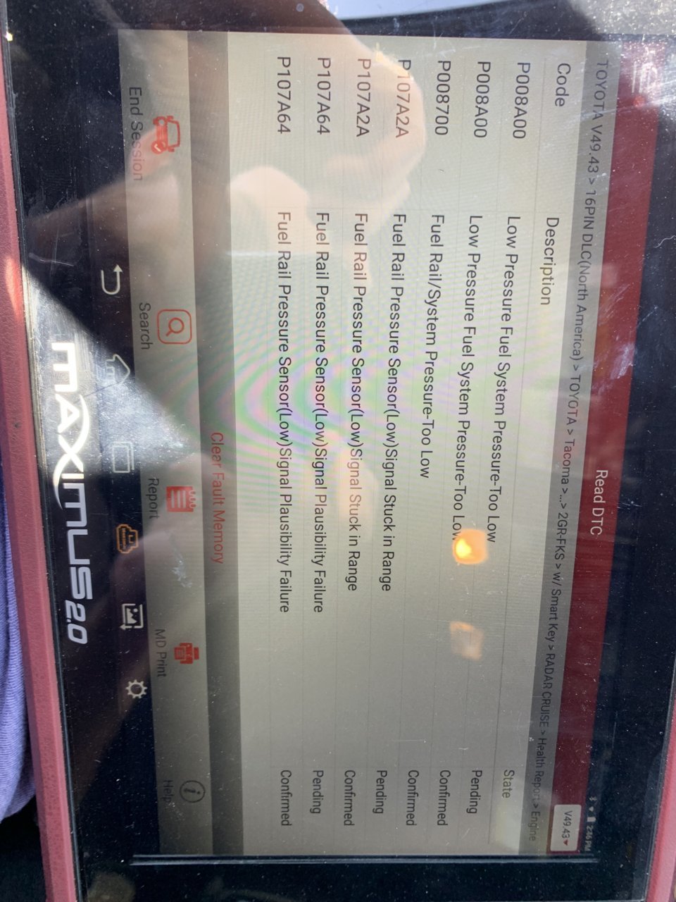

    much to my delight, I'm happy to report my '18 4x4 offroad is having similar issues, usually in 2nd/3rd gear above 3k rpm, truck will just "die" and has to be restarted to get the power back. CEL and traction control lights came on. Happened today so haven't had a chance to get the issue looked at yet. has about 21k miles on it.

    Update: for anyone wondering what fault reports popped up, I ran them and got the following. Looks like it’s directly related to low pressure pump, as stated earlier in thread. Taking it to my dealership tomorrow to see what they say. (Sorry for crap image, posting from mobile)
