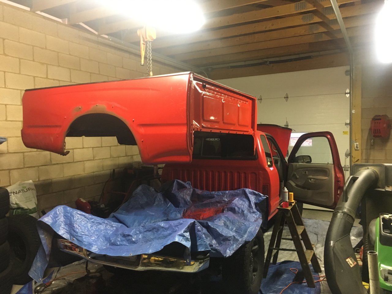

    kristi with a k, what kind of hoist?, do you have pics of the situation at hand?

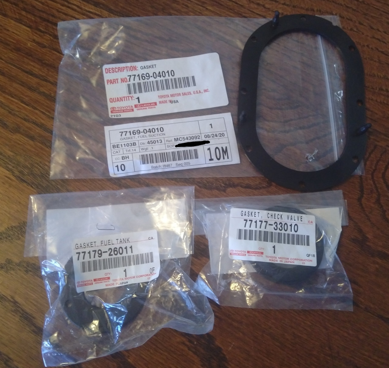

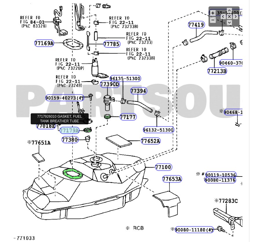

    Here's what I bought. I just looked for anything that said "gasket" on the top side of the tank on partsouq.. I think the gaskets are for the sending unit, filler neck breather tube, and check valve.
    [EDIT] Here's the parts diagram from partsouq, gaskets highlighted in green

    Kristi with a K[OP] and GQ7227 like this.

    I've never dropped the tank or removed the bed, so I'm the wrong person to ask. Based on my reading here on TW it seems like more people think removing the bed is easier because you can keep the fuel lines attached. My frame was replaced last year so all of the bed hardware is shiny and should (hopefully) be easy to remove. I'm planning on coating the frame in Fluid Film while I have the bed off, so that is also driving my decision.

    I’ve not yet had to “drop” the tank. (I love that. Makes it sound like a walk in the park. May be for some, however i’d be st it for two days. All good though.) Plus the assembly is purty long, so probably a little tricky getting it out after you “drop” the tank. Timmah does have a vid on doing it. Anyway, hoisting it is cool cuz I am going to town on the frame & bed with the ww & ff.

    ya, i don't know either which is the best way to go. removing bed seems to be a very awkward and potential hazard & body damage if something slips up or whatever
