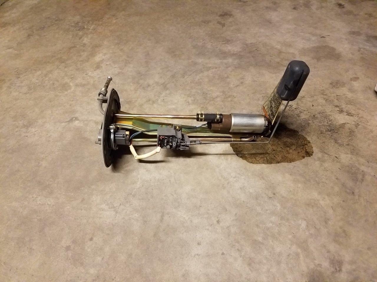

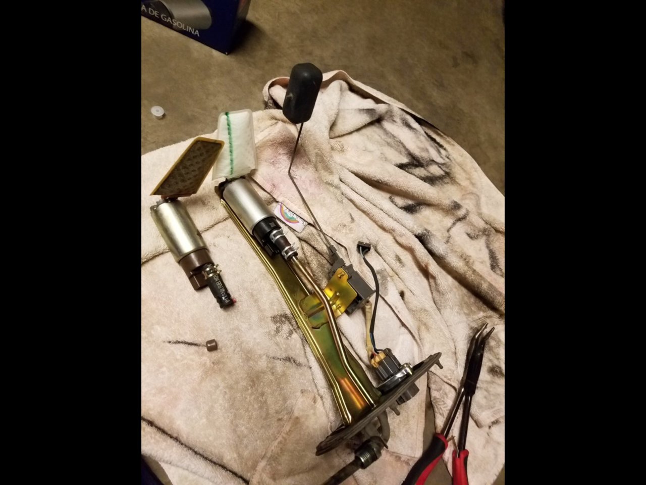

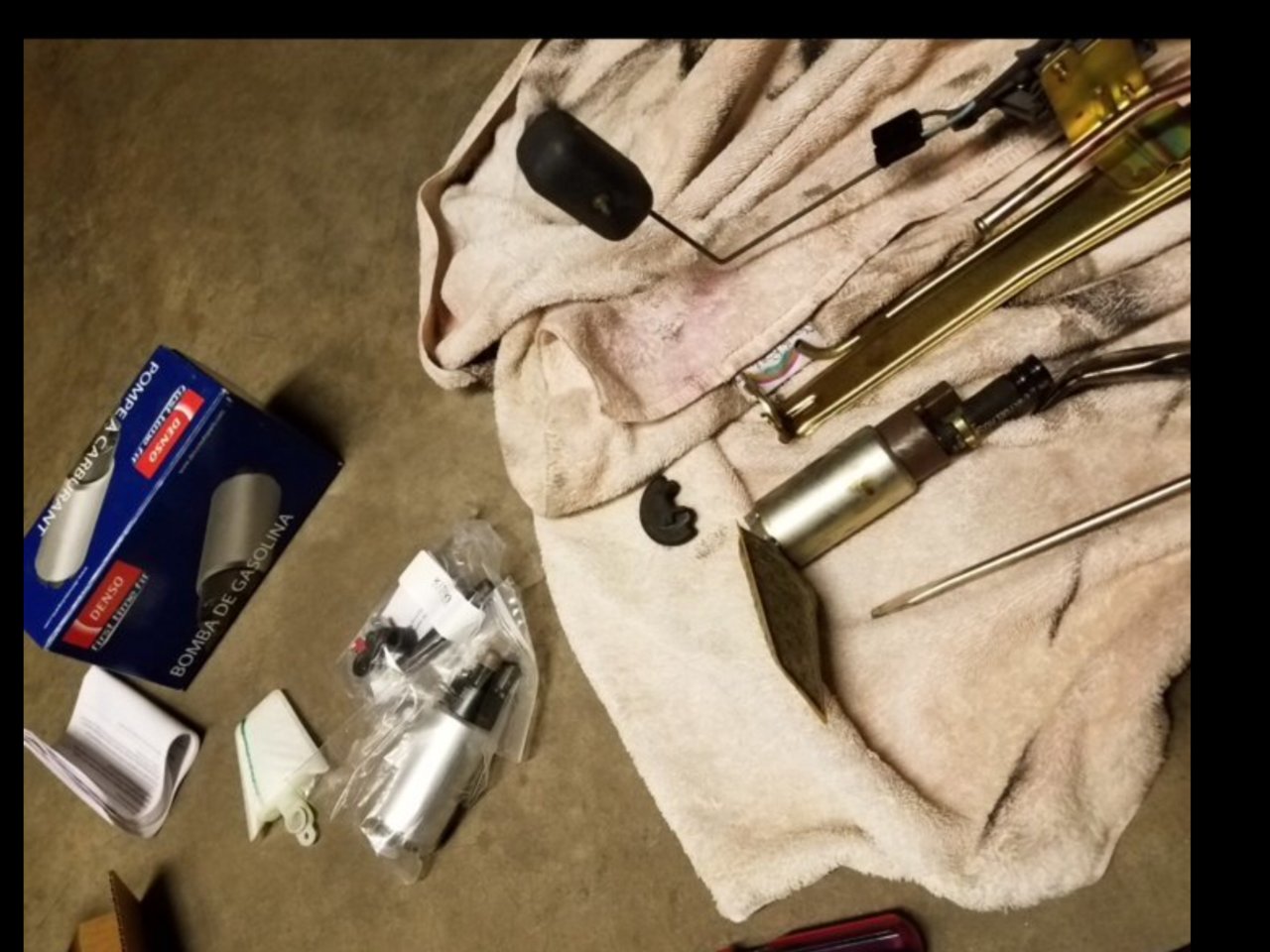

    Very easy swap out

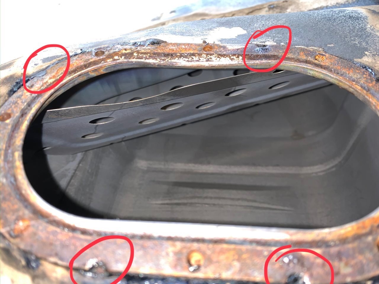

    How did you clean the mating surface before installing the fuel pump bracket gasket?

    Emery cloth, work your way around the opening a little at at time and hold and dampened rag underneath where you're working to keep dust and metal from falling into the tank.

    Hey I recognize that crusty gasket surface!
    This was my old tank, and that surface was corroded beyond sealing. It would just seep fuel when the tank was full, or sloshing around. Replaced with a scrapyard donor and scraped it clean with a razor and some brake cleaner.
