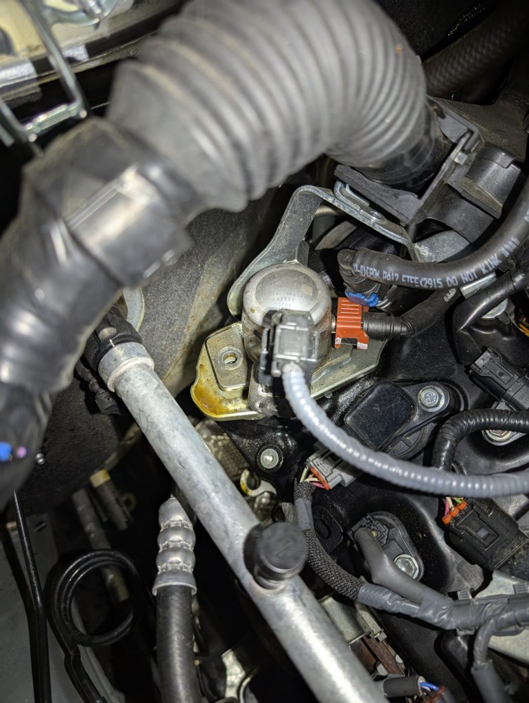

    Truck lost power and threw a P0087 code, seems like the fuel pump lost a bolt. This is a '23 with only 17k miles so I'm pretty pissed. Just wondering if this is something that has happened to anyone before? Kind of blown away since I've been driving 25 years and had many cars and never seen something like this happen.

    I wasn't able to fix it because the bolt was just..... gone. And it's under warranty so I'd prefer to have it done right and be on record with Toyota in case this leads to further problems down the road somehow from all the oil that sprayed out. I'll have to get it towed to the dealer during the week.

    Spraying oil, from where? :confused: I thought we were talking about a fuel pump.

    from experience & what ive seen on fords....
    Look down the hole & see if the bolt broke....
    They usually dont just come loose & completely fall out....
    unless you removed it after you realized it was lose.

    It felt/looked like oil to me (see the picture) but maybe it's just fuel.

    I dont know shit about toyota engines...
    But looks like a cam driven high pressure fuel pump...
    So leaking oil makes sense, as its lubricated from engine oil, mounts top of valve cover area or its own pedestal, but its submerged into the engine....
    gets lubed by splashing engine oil on top of the cam...
    theres an orange or gasket, if its missing a bolt, its not making a seal....
    That being said, the way im reading the recall, states nothing about broken bolts, stuff coming apart, etc...
    the recall clearly shows they've had issues with pumps leaking fuel.
    Not sure what to make of that & coverage.
    OP, has anyone been in the engine for anything?
    Theres alot of stress on those pump bolts as pump rides on came lobe..
    Ive seen alot of trucks boomerang as some rookie techs didnt torque those bolts correctly.
    I dont torque everything but I know what is a big deal, & not....
    torquing this bolts properly is a very big deal as bolts are small & they deal with lots of stress, force, pressure, etc...

    I don't see any rust so I am thinking either whoever did last service took that screw/bolt off OR it was never in there in a first place from the factory..
    There is no way the bolt/screw unscrewed itself out of no where, someone did that sht on purpose or in factory they forgot

    It's possible, I bought it used with just under 15k miles and it just hit 17k. I haven't had any work done myself but it has had some suspension mods. I don't see why anyone would have messed with the fuel pump bolts though....

    Perhaps the campaign detailed in the link in post #6 was already done before you bought the vehicle, and the dealer did it incorrectly. A unique possibility.

    100%, totally makes sense to me....
    Those bolts have to be torqued for this very reason & theres good mechanics, & very bad ones...
    Theres alot that think theyre good....
    Have the dealer review repair order history & actually show you...
    Or better yet, call them on Monday & give them your vin without telling them the scenario....
    Ask them you were internet surfing & want to know if the "high pressure fuel pump recall" was ever done to your vehicle...
    Let them spill the beans, before you mention theres an issue....
    I dont remember what its called but another member mentioned it here, you can go online & review all your repair order history done at the dealer level....
