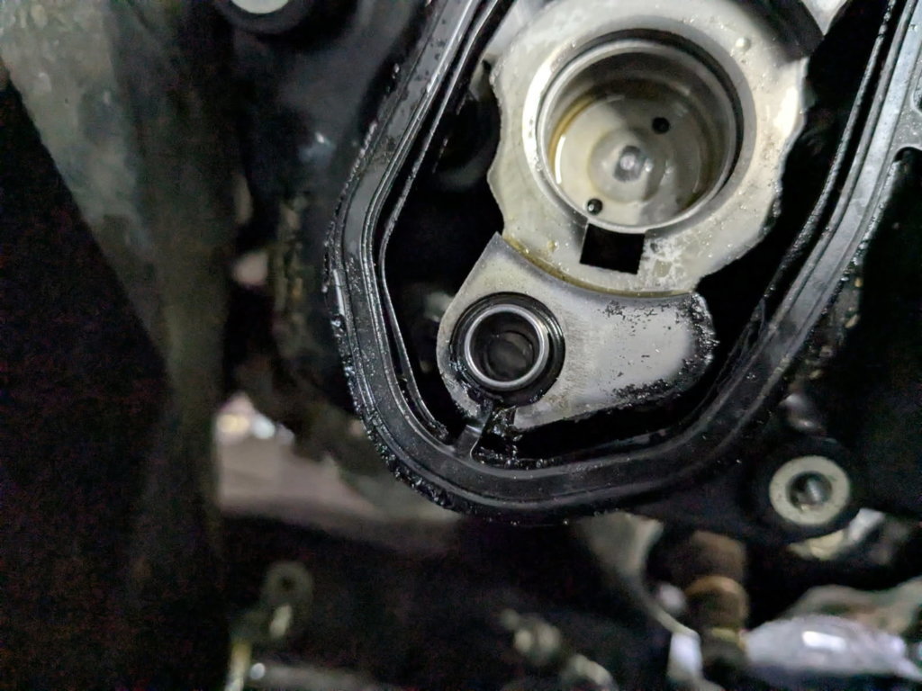

    what did they say is the “extensive damage”? That does look like oil to me btw

    They showed me a picture that looks a bit like metal shavings, which I think is under where the fuel pump was. They're currently taking off the valve cover, said there is damage to the cover and they're checking for damage to the cams or whatever they find under there.
