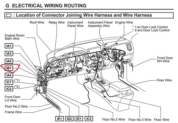

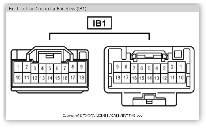

    So it sounds like you have a voltage drop (poor connection) on the fuel pump circuit, I'd check Connector IB1 Pin 8 (Black/Red). Not uncommon for that pin to get burnt and lose connection.
