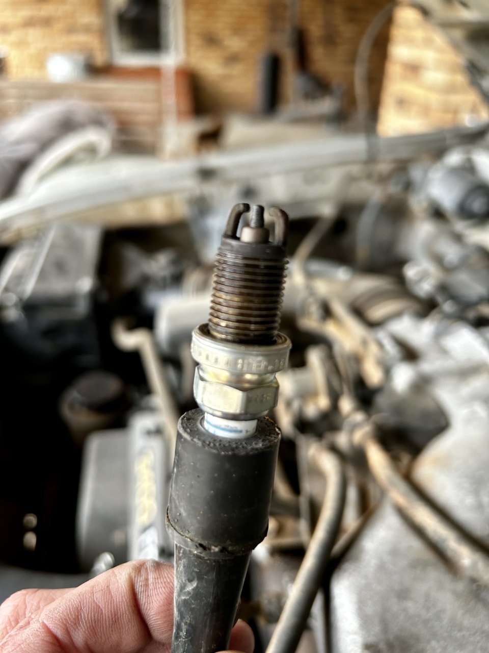

    Pulled out the first 2 plugs on the drivers side (pic of plug 1 attached). They aren’t new for sure but they don’t look fouled to me. Lined up a screwdriver on the intake plenum to check spark/arc. They are both sparking good. I’ll inspect the rest of the plugs. Starting to suspect the old gas is the issue…just seems strange it starts intermittently and idles smooth and strong once it’s started if that is the case.
    I want to punch myself in the face for not draining the gas when I had the chance…
    Edit: It started when I had plug 1 out while checking for spark. Could have been a fluke since it does start about 1/20 cranks

    That plug looks relatively normal, depending on mileage.
    Stale gas is the most likely suspect in everything you have described so far. Best approach now, especially if you haven't filled it up yet, is to drain the tank, add a couple of gallons of fresh gas, agitate and drain it again, then add another couple of gallons of gas and run the fuel pump from a 12V source and collect the pumped fuel into a container just before it goes into the fuel rail(s). Once you have flushed that stale gas from the lines, try to start it again. If you can get it to fire, you will be good to go. Nowadays, with the ethanol they mix into the gas, any fuel over three months old starts to be suspect.
