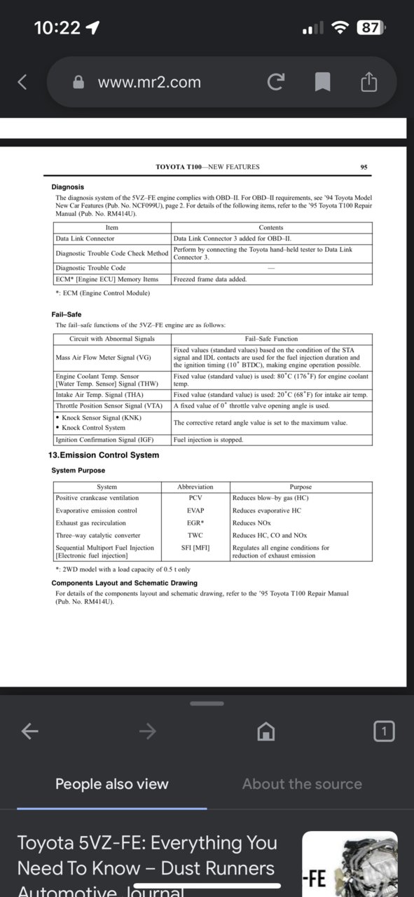

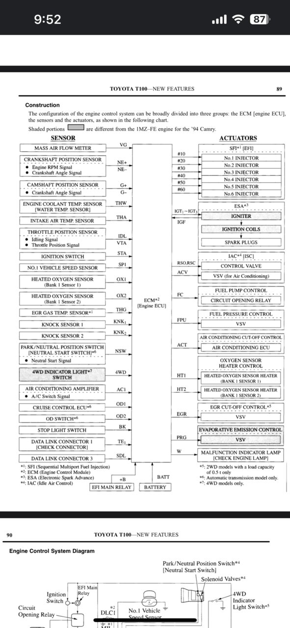

    Finally got around to pulling out the crank position sensor to get a look at it (despite no codes). Wires look fine but the sensor itself and the housing it sits in is CAKED with 250k miles worth of road gunk. Cleaned it all up well (with dry towel, no liquids or chemicals). Found a helpful list of fail safes and a diagram of what controls what for ignition signals (pics below).
