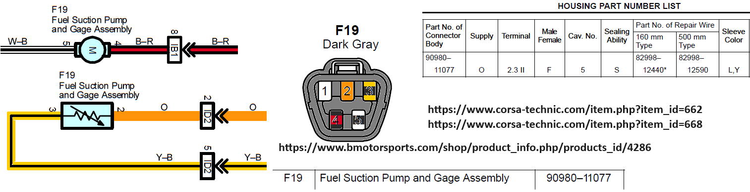

    Mice chewed off wires right at the electrical connector.
    Its a five pin connector with four wires used - two for fuel sending unit and two for fuel pump power.
    I would prefer OEM connector with say 8 inches of pigtail wiring attached, but can't find Toyota part number along with picture that confirms to me its the right item.
    Here's the right connector, used on ebay for ridiculous price:
    Anyone know the OEM part number? Are the Amazon china $11 one's good enough?

    Thanks......diagram helps.
