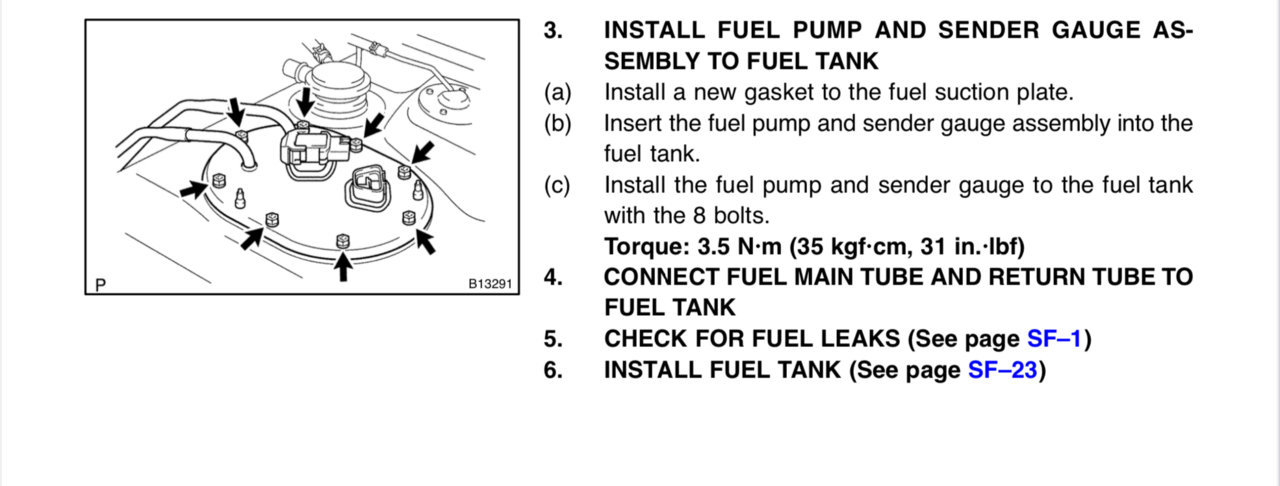

    Is there a torque for the screws/bolts for the fuel pump gasket?

    Is this what you are asking about?
    This is for a 2003 with 3.4 engine.
    I would say the specs are probably the same.

    Perfect, thank you!
