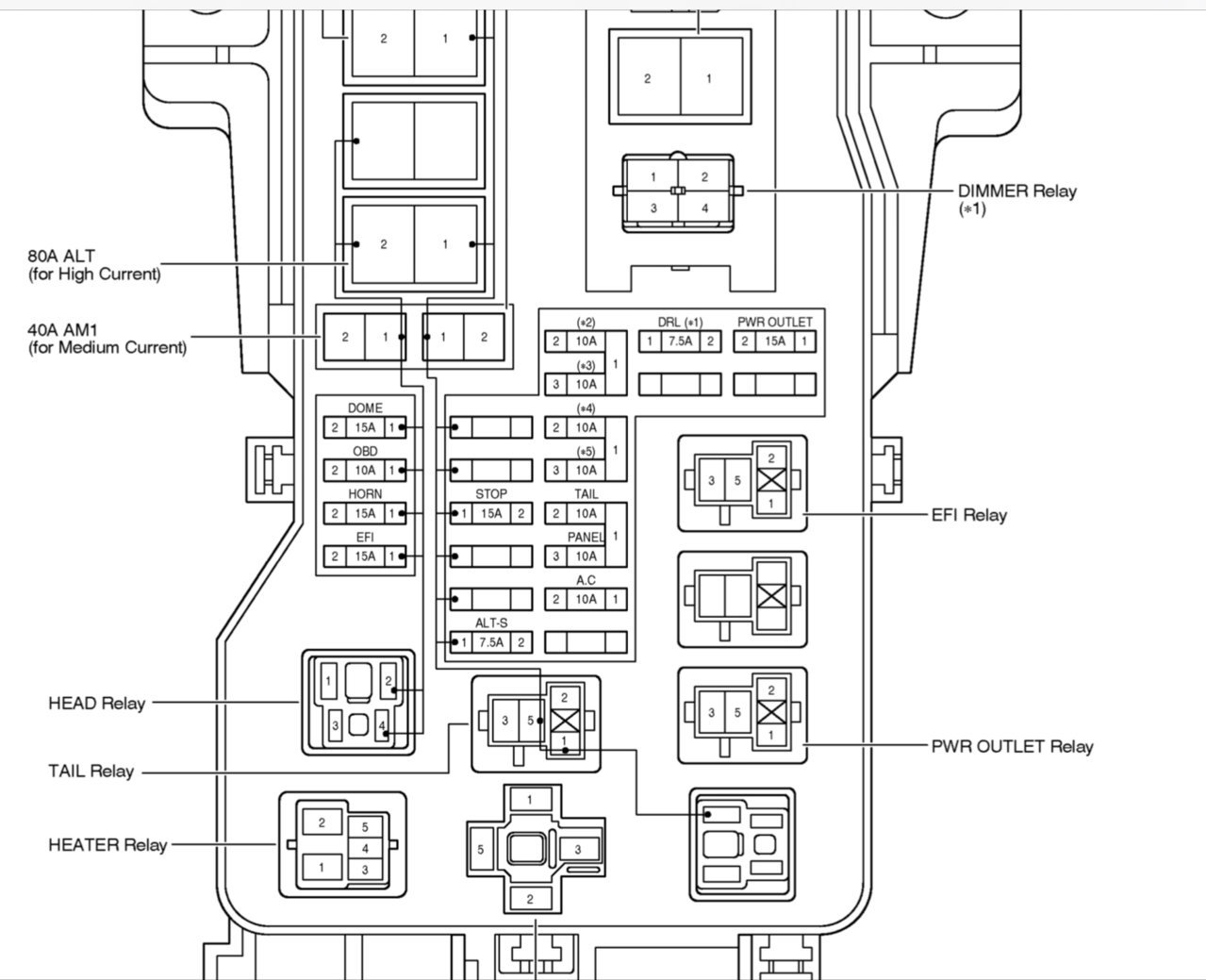

    I appreciate all your help immensely thank you!! Ok yes power to one pin has changed. Originally when I pulled the FPOC relay it had power to #2 and I jumped that to each of the other pins one at a time and nothing happened till I jumped to #4 I THINK and it blew efi fuse. I just checked c6 plug and no power to any pins ignition on and off no difference.

    The #2 pin is powered by the EFI relay.
    The EFI relay is powered by the EFI fuse.
    Check EFI fuse. If good, pull EFI relay and check Pin # 3 of EFI Relay.

    Check pin 3 of efi relay. Why dont I know which pin is 3?? Watch to see if check engine light comes on when key turned on. Got it. Except pin 3

    You have a blown fuse most likely. Either 7.5 IGN or 15 EFI is blown

    I wanna say PIN #1 is hot

    Drabt100 IGN15 is the upper one in the dash fuse panel correc? It's good along with the EFI15 under the hood

    IGN should be a 7.5 amp fuse in the passenger compartment fuse panel. I do not know the location in that panel. Should be a sticker on the inside of the panel cover showing the fuses and what they are for

    Ok you should have 12 volts at terminals 1 and 5 of the EFI relay connector with the relay removed, key in the on position.

    The EFI relay under the hood correct? Not the fuel pump open circuit relay.

    I only have 12v tp pin 1

    15 amp EFI fuse powers terminal 5 and the ECU. Check it again
